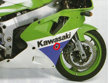

The next pain in the arse hiccup has reared its ugly head...
The new second hand side fairings I bought off ebay had been repaired when I bought them, but the repairs looked pretty good, and the J has unique fairings to any other model ZXR except maybe the K so I didn't think much more about it. Until now.
The circled mounting hole (to the radiator bracket) has been completely reconstructed on the right hand side. The blue sticker that goes on the side has two holes in it, one for the one circled mount and one for the screw towards the front that mounts into the front belly pan cover thing. The hole circled in the picture it turns out is in the completely wrong fucking place and doesn't line up with the sticker (or I assume the mounting bracket under the fairing).
So now I gotta get a lug to mount to the nose cone welded back onto my old right hand fairing (from where i had one cut off and welded onto the dodgy one because I thought it was better :evil: ) and have it painted so the stickers can go on.
Lucky it's in reasonable nick, would have been in much better nick before I had it cut up to repair a "better" one but them are the breaks I guess.
