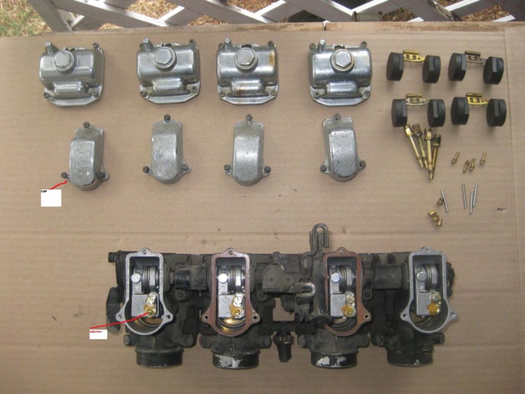

ok gos the info you are giving me relates to cv carbs they are a piece of piss and yes the adjusters are between the carbs i am talking old school mechanical round slides with adjusters under the caps that look like screw and locknut rockers unfortunately i cant take a photo cause some little asshole has jumped the fence during the night and made off with both sets of allen keys which i had sitting on the dog kennel if it had of been a big asshole the could have taken the compressor as well so i cant remove the caps until i buy a new set . i use a 1litre thinners tin hanging from the roof with a breather in the bottom which is the top when hung and i also have an industrial fan which also gets used to keep my stereo gear cool will add a pic if i can find one. ok found pic where is add image i have done images before but cant seem to now

OK image works i am sure the gaskets and caps are not just to keep the bugs out
