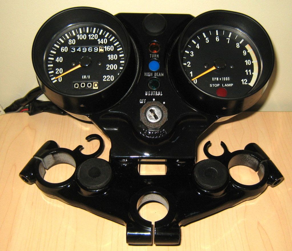

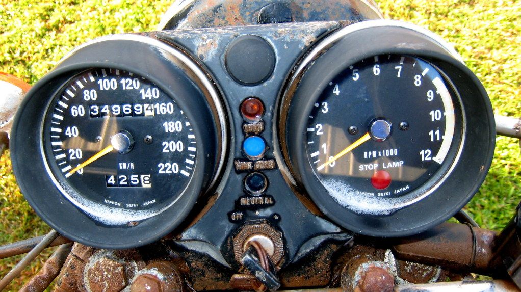

Now that I'm incapacitated ...... :oops: after accidentally kicking the hydraulic floor jack........dislocating my second toe from the big one, and bending it at a right angle.
Had it sorted after spending 5 hours at the hospital having x-rays...and a local anesthetic ,"which hurt like buggery" BTW :cry:..then had it pulled straight.
Anyway not walking real well ATM...but did manage to refurb the gauge pods.
Before........................
And after.....................

Bloody queenslander ! wasnt wearing thongs by any chance Dave? if not you mustve gave her a good kick :lol: Tell me Dave what is the secret to getting the faded plastic back to new, some kind off paint or some kind of polish ? and with the lettering what was used for that some kind of paint pen ? please tell
h.b.bear
Posts: 1175
Location: Tamworth NSW
Re: Project KH500 triple resto....
Postby kawadave » Fri Aug 31, 2012 8:06 pm
I wasn't wearing my Japanese riding boots Gary... :D ..and it happened at a panel shop I was working at. :oops:
Plastics come a treat using any old spray on furniture polish.
The gauge center on this was easy...painted it with PJ1,then baked in the oven.
Because the lettering is raised...I just ran a small nail file over the top,then clear a coat to finish. :kuda:
