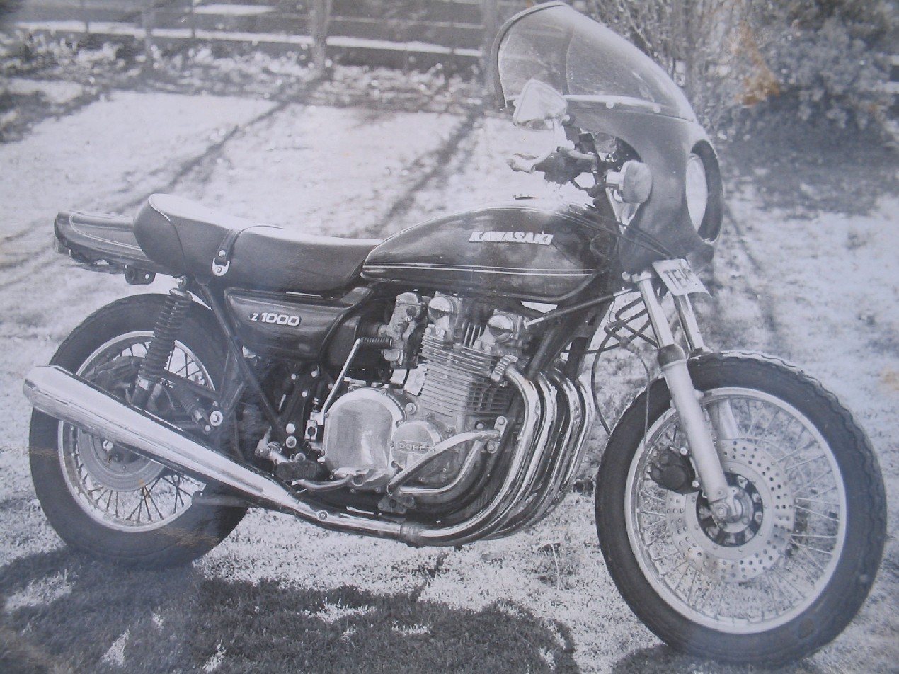

Postby paul w » Thu Jun 25, 2009 2:04 pm
And this was it, back in the day...
paul w
Posts: 83
Joined: Fri May 01, 2009 4:23 pm
Re: okay, let's get it back on the road.
Postby paul w » Thu Jun 25, 2009 2:07 pm
I never liked the front and rear guards, although the front one I put back on. The rear was the original long thing...looked crap. I much preferred a 'cleaner' line around the rear end, as I really liked the ducktail shape...very Kawasaki, and I think the rear guard took focus off the thing. And don;t those four exhausts look the shit, eh? Although, now looking at the thing, that fairing was a bit big, but it worked really well. Did lots of miles on this one. Great shape, though.
paul w
