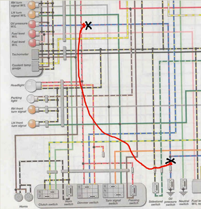

BrettZZR wrote:You don't want to bypass the switch - you say it's working?
Find the wire coming from the oil light, and...
See pic...
This diag is from an early ZZR - you *may* find the wire colour (Blue with red line) is even the same.

BrettZZR wrote:grytvikken wrote:... When I say bypass ...
Then do as per drawing. Don't forget to cut the dodgy wire out of the circuit (black crosses).

grytvikken wrote: ...I have tried your idea and it doesn;t help im afraid. light goes out totally and stays out. thanks for your idea though.
