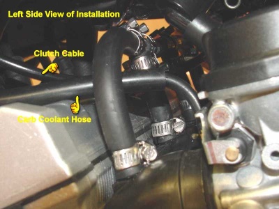

The Carburetor 4-Way Crossover Equalization Manifold is a simple assembly of hoses, T-connectors, and hose clamps which is placed over the existing vacuum spigots between the carburetors and engine. These spigots are normally capped with rubber covers which are removed only when performing a carburetor synchronization.

Bill Jinks now recommends an simpler manifold as an alternative. Use two lengths of hose to connect cylinders 1 to 4 and 2 to 3 separately. The benefits from this setup may be nearly equal to the more complex four-way manifold. It also has the benefit of eliminating all the connections made necessary by the 'T' connectors and the additional potential of air leaks.
