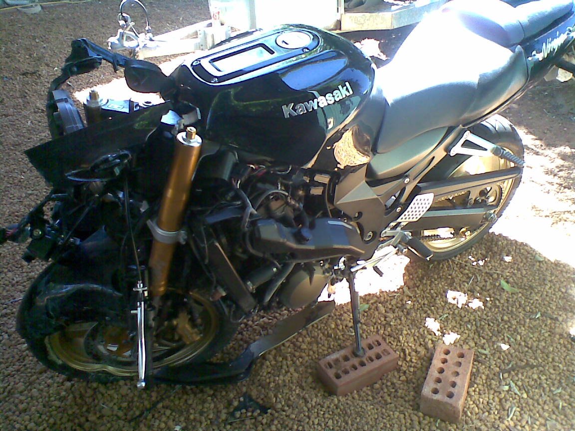

2. As mentioned , has the bike been binned ?? ie cracked headstem / weld / bearings (see pic)
3. Wheel bearings OK?
4. CORRECT wheel / bearing spacers?
5. Irregular tyre wear / scalloping / out of balance?
Balls dead 12.jpg (189.72 KiB) Viewed 2626 times

:shock: jeezus that hit something hard !! snapped the fork right out of the top clamp......bloody ! :shock:
