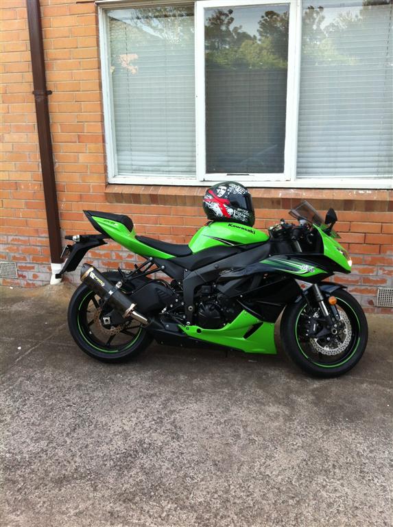

Re: ZX-6R buying guide - advice needed
I have a 2011 ZX 6R with 4500 kms if you want to buy. I have roadworthy etc etc.
2 brother carbon slip on. No other mods.
- IMG_2066.JPG (98.71 KiB) Viewed 5833 times
