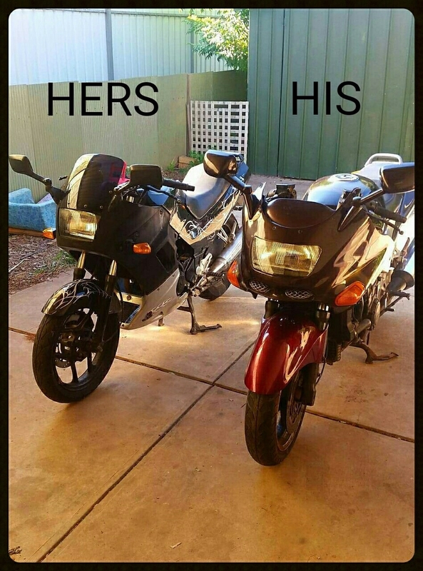

Here's a happy snap, not exactly a piece of art but it's a work in progress.
