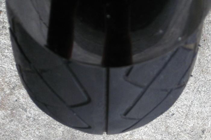

The_Fixer wrote:Tyres may also be prone to catastrophic failure past this time frame,
Suits my riding style then.

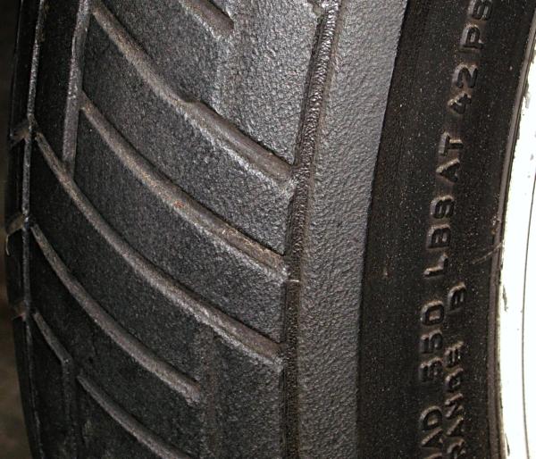

Not much tread left in the middle of this Bridgie BT17F but still plenty left to exploit on the sides.
You could always employ the Burt Munro principle and use the neighbour's carving knife to resurrect some more centre tread. :P :kuda:

The_Fixer wrote:You could always employ the Burt Munro principle and use the neighbour's carving knife to resurrect some more centre tread. :P :kuda:

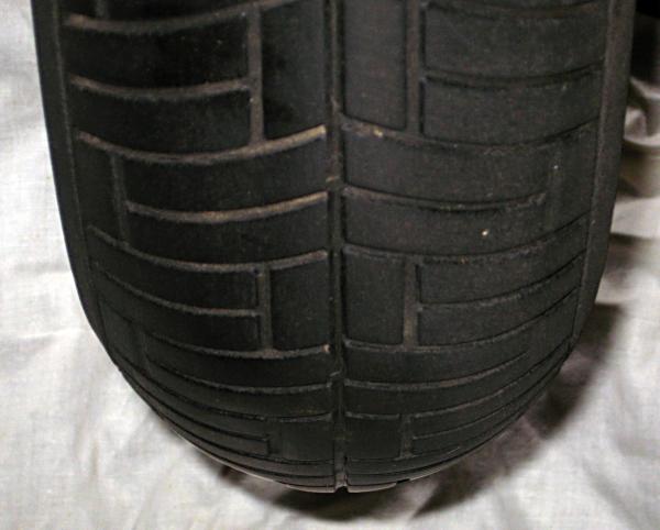

Nothing quite so dramatic required yet. The profile pic of the Bridgy shows that the previous owner did not spend much time searching the outer limits, there are 2 definite arcs there:
On ther other hand I could commandeer the Metzeler ME33 Laser from the front of my RC17. The Metzys have alway been good to me:
Happily tips in so a good match for the quick-steering 16 inch front on the RC17
The ME33 didn't mind life on the edge although the footpeg, sidestand and centrestand complained loudly:
I want to get my money's worth so I try to use all the tread
I won't rule out a Bridgestone BT45 but I'd want to see how much tread those have up the side when fitted and inflated. The GPX has more clearance than the RC17, at least on the left hand side.
Heck, I wouldn't rule out Dunlop K205's (OEM fitment) if they were still available. Pics from the era showed good tilt possible:

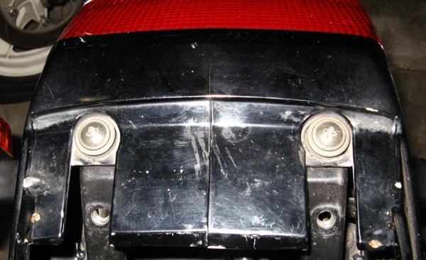

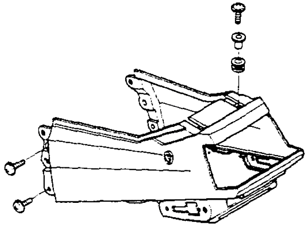

Sadly the GPX750 is not perfect. The obtrusive sidestand spring is one example. Here is another.

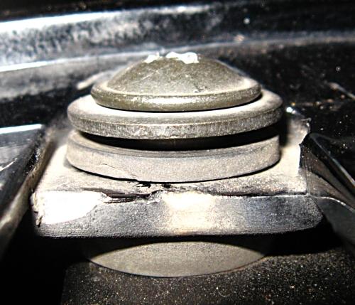

It is not unusual to see pics of a GPX with the bottom corners of the taillight broken. Here is one possible explanation.
The tailpiece is not held very securely:
A couple of screws on each side at the front hold the tailpiece rigidly to the subframe. At the rear, the tailpiece hangs from a bar under the grab handle and is isolated through rubber grommets (aka "damper" in Kawi speak):
Wobble, wobble, plastic and trouble. Too much movement here.
This leaves the rear of the tailpiece to flex around. The wide indicators attached directly to the tailpiece and nothing else make things worse by flapping in the breeze and their weight is exaggerated by sticking out so far, leverage and all.
The close fitting tailight gives up trying to keep the tailpiece straight and flips its bottom corners out.
It's not just twisting movements, there is up and down as well. The dampers don't do much damping after a while:
I don't think there is supposed to be a gap here
All that movement does not do the rigid mounts at the front any favours, either.

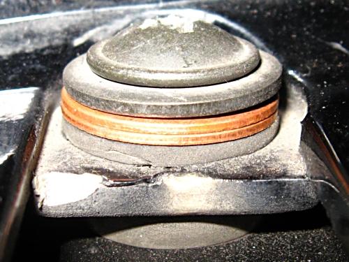

Here I have inserted a couple of thin washers to stop excess movement. Each washer is about 1.2mm thick. With thin washers you can put them above or below the damper to adjust the rear height of the tailpiece.
Maybe a single 2mm washer would be better and preload the damper a bit less.

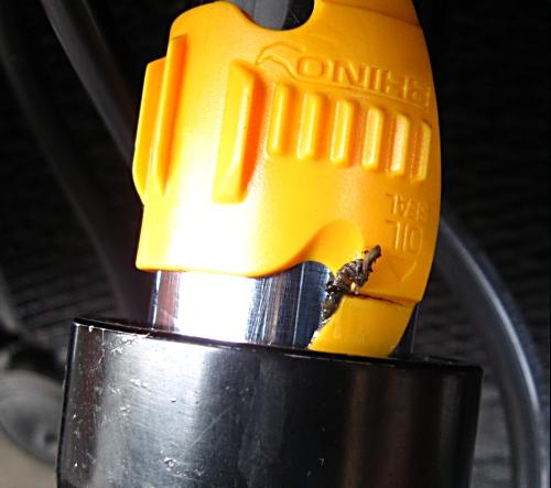

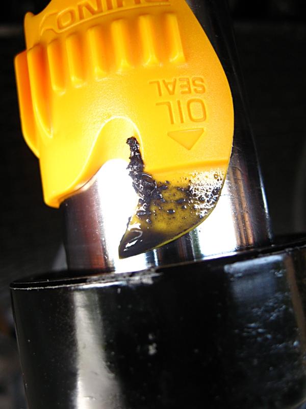

The right fork seal on the Resurrection GPX has been leaking of late. It leaked not just when riding but when parked up on the centrestand. Some leaks just leave a stain you wipe off occasionally, this leak was enough to run down the fork leg onto the caliper. :(
I'd seen the Seal Doctor around on websites and decided to give it a try. It is designed in Australia and endorsed by Geoff Ballard so it can't be too bad. It was designed for upside-downy dirt bike forks but fork seals are fork seals and the tool will work on right-way-uppers as on the GPX 38mm KYB units.
There is a link on the RhinoMX website ( http://rhinomx.com/ ) to a vid that shows Geoff Ballard demonstrating the operation of the tool.

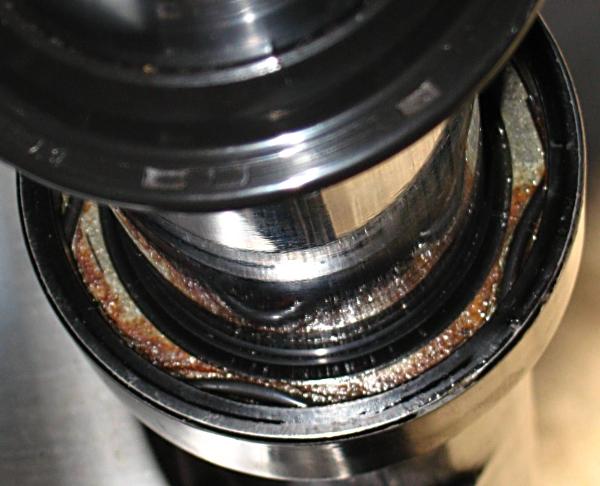

Here is what came out the the right fork seal after one rotation:
Barf me out, gag me with a spoon, like totalleee
Yeah the oil is due for replacement as well, but that is a lot of nasty looking gunge to be near a sliding chunk of precision metal. I cleaned off the tool and gave it a couple of more laps and ended up only getting dirty oil.
The left fork was not leaking but I gave it a shot anyway:
A bit of snot there
A bit of snot there
The left wasn't too bad but apparently worth doing.
The result so far is the right fork seal no longer leaks when parked. Crikey
I haven't ridden it yet so we'll have to see what happens there but so far it's a win. :D
Tomorrow looks like it will be nice weather to burn a log book day and see how the fork seal holds out.

I've been for ride, taken the GPX over speed bumps, corrugations and level crossings, let it sit in the sun and parked it overnight. No pool of fork oil detected! Bonus win! :D
I avoided pulling a monster wheelie then hitting the rev limiter and slamming it on its nose. That would be just asking for trouble.
No more zip-tieing a discreet black rag around the top of the slider, for a while at least.

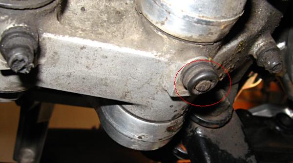

One of the things I noticed when I first peered into the dirty underworld of this GPX were the tantalising grease nipples on the Uni-track rocker arm. The middle one has copped some rust and damage.
From the factory these greasing points are a very welcome addition to important parts of the rear suspension.
The caps on the nipples are not factory items so it seems that sometime in the past somebody has shown some consideration.
The middle nipple won't take grease so it will have to be swapped around with another one for now.
Ready for some gentle pumping with Penrite moly grease.
Not shown are the the nipples at the top of each dogbone which are fairly easy to get to as well.

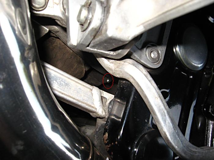

The swingarm has its own greasing point. The problem is that it is a bit tricky to get to.
In this dark and dirty recess lies the hidden grease nipple for the swingarm.
Attaching a grease gun to this swingarm may require skill, daring, cunning and dedication. And then I will have to get the gun off again which may be a whole 'nother story.
This pisses me off because chances are that since the swingarm is difficult to lube, it may never have been done. The Uni-track links are easy to get to and at the moment may require lubing less than does the swingarm. Out of sight, out of mind.
All the 106-odd neddies the GPX can produce work their way into the frame through two small needle bearings in the swingarm pivot. When the rear brake does its job it tries to pull the swingarm out of the frame. All this happens while the rear wheel is bouncing around. It's a tough life being a swingarm bearing. Show them you care.

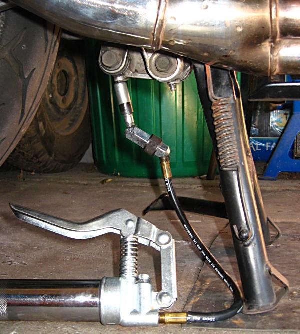

never had a problem on mine....
but
my McNaught grease gun had a flexible rubber hose and snap on/snap off coupling (you can hear it click on and a quick twist and its off)

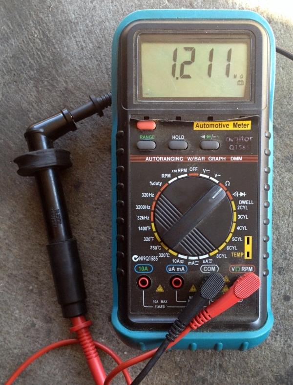

What is it with these stupid plug caps?
Is there somthing I'm doing wrong? This is getting old, fast.
It's not like the coils put out a massive amount of power, the spec plug gap of 0.65mm (or 26 thou) confirms that.
It's not the same cylinder affected as last time but it's on the same coil. Coincidence? Hmmmm. dontknow.gif
The meter is probably only reading a carbon track from the burned out resistor.
On the plus side, it does cause a lumpy random idle like a race cam. 8)
