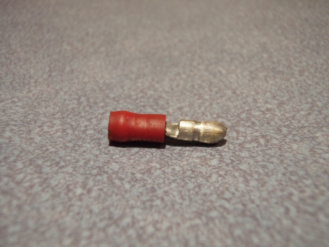

Alright after much stuffing around, misdirection and just plain and simple having to learn a bit about how things work, I've finally sorted out the problems I was having with full throttle on this bike.
The cause of my problems is shown below...I'm calling it the Bastard Arsehole From Hell Satan Spawn Plug. It was one of the ones going to the coil for 1 and 4 and basically despite appearing to be crimped on to a wire properly, it was in fact barely hanging on (and yes I had checked it earlier but obviously not well enough). Combined with the other wire's connection being a bit dodgy too, it meant I was getting poor spark on 1 and 4, which I then compounded by playing around with too big jets :roll:
Jets back to what was originally in it (110), all relevant connectors checked, cleaned and replaced where necessary with nicely soldered ones, and fark me it goes like a rocket now!
Mick C wrote:.....It was one of the ones going to the coil for 1 and 4
was this part of the additional wiring for those solenoid things ??

Gosling1 wrote:...was this part of the additional wiring for those solenoid things ?? ...
Nah, I would've never done something that dodgy, but I did undo it while I was wiring up the solenoid and didn't notice it was quite that loose :evil:

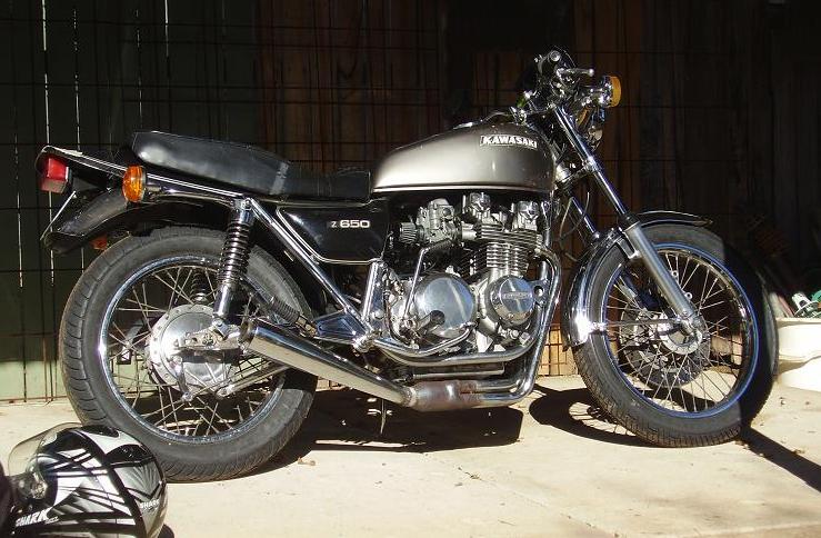

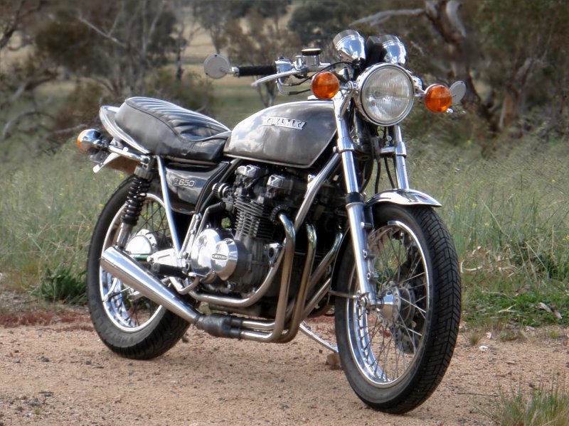

Re: Z650 Resto Project
Here she is with the new bar end mirrors and end plugs
...I also photoshopped the dodgy mismatched indicator lense :oops:
