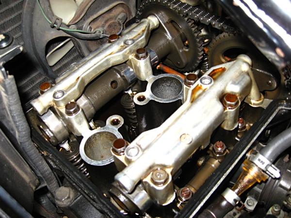

I finally got around to taking the cam cover off and doing a check on the valve clearances.
I was curious to see if there had been any loosening of the cam bearing cap bolts.
Readers with a long memory will recall that I cured an apparent camchain noise by finding that a few cam bearing cap retaining bolts were loose. Some others had been somewhere near finger tight.
It was nice to find that all looked and felt well inside this time.
Pretty clean inside. I like the user friendly valve clearance adjustment.

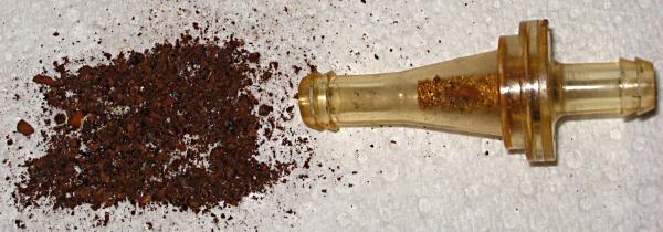

Eagle-eyed readers may have noticed the questionable appearance of the fuel filter in the above pic.
The concern would be justified as the filter was almost clogged with rust from the tank. The cheap filter did its job and kept the nastiness away from the carbies.
Here is a close-up pic of the filter and most of what came out of it.
Oh dear.
Oh dear.
Any suggestions of products or services in Melbourne to fix the rust in the tank are welcome.
When I poked the feeler gauges around the rockers the only ones in spec were #3 intake.
The rest of the gaps were all below spec.
Either the rockers were never done before or somebody did them wrong in the past. I suspect the latter.

I used POR15 kit (just search ebay about $100) which is a 3-step process to line the tank:
1) detergent
2) acid
3) lining
It had worked well the past 2 years but after some more reading there is a debate whether to line or simply remove rust using typical acid (posporic, etc) plenty from bunnings.
I would have tried just removing the rust and top up the fuel every ride first. Liners can fail eventually and it will be a harder mess to clean and fix. While acid cleaning is simple.
My tank came with that Kreem lining and it was a complete pain to remove the flaking. Do not use KREEM!!
-ariel circa 2007

javaman wrote:I used POR15 kit (just search ebay about $100) which is a 3-step process to line the tank:
I'll keep that in mind.
javaman wrote:It had worked well the past 2 years but after some more reading there is a debate whether to line or simply remove rust using typical acid (posporic, etc) plenty from bunnings.
I'll also have a look at the common "rust converter" products. Phosphoric acid? Maybe a few cans of Coke will do the trick?
The GPX tank has the added disadvantage of having to close the extra hole for the guage sender while treating the tank somehow.
javaman wrote:I would have tried just removing the rust and top up the fuel every ride first. Liners can fail eventually and it will be a harder mess to clean and fix. While acid cleaning is simple.
I guess lining is ok until the tank is dented somehow. Then the lining could crack up or complicate repairs. I would not fancy doing any welding on a tank that has a lining in it.
javaman wrote:My tank came with that Kreem lining and it was a complete pain to remove the flaking. Do not use KREEM!!
I wonder how the present owner of my old KLR600 is going. That tank got Kreem about 27 Years ago.

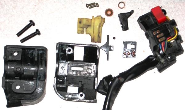

While the tank is off I figured I might as well clean the right hand switchblock.
Such is life with an old bike, it is easy to be consumed by the "might-as-wells".
I just wanted to check the condition of the contacts and renew the dirty old grease. It came up nice.
One down, one to go.

Mister_T wrote:While the tank is off I figured I might as well clean the right hand switchblock.
... first thing I did with mine
(as the switch block kept playing up)
