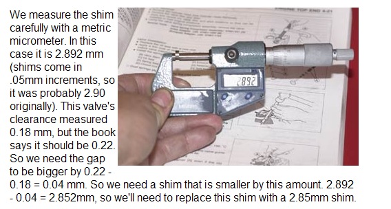

Further study... YES the gap actually closes, not widen :shock:.... boy have I got it sooooo wrong :shock:
Thanks Strika!!!

:lol: but I got to do it anyway so it will... I think the 8hrs taking account of going to to shop to get the new shim. This can't be pre-prepared as the current gap needs to be measured :cry:
