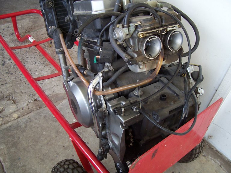

Well I've got it in the frame. I put the whole unit - radiator etc straight in. All I had to change was the top radiator hose. Where does the clear tube from the centre of the carbies go to? I think it was laying behind the coolant expansion tank when I pulled it apart... but I've forgotten.
Click for bigger pic
Daisy wrote:...Where does the clear tube from the centre of the carbies go to? I think it was laying behind the coolant expansion tank when I pulled it apart... but I've forgotten.
at a guess I would say that is the fuel inlet hose ? If it is a large-diameter (say 6-8mm), it is probably fuel hose. If it is the small-diameter hose (3-4mm), then it may just be a carbie overflow hose.
Does it point up or down when it comes from the centre of the carbs ? ( I don't think it would be a hose from the overflow tank :shock: )
Daisy
Posts: 1394
Bike: GTR
Post by Daisy »
No there is a t piece between the carbs on the airbox side and a clear plastic hose comes from that. The manual doesn't tell me anything about it so I guess its just a breather. I'd like to put it where its supposed to be. Don't want it catching fire or anything.
Yep, carbie breather. These *normally* route to a location behind and below the motor, so any fumes are drawn away from the engine area. There might be a small 'loop' attached to the very front of the swingarm, that the hose is meant to be routed through ? this places the end of the hose down low right in front of the rear wheel. If you can't find any other reference to routing this hose, then this is where I would put it.
