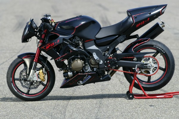

WARNING : TEMPORARY THREAD HIJACK !@! :shock:
Froggy - will it look anything like this ?......
How a 'fightered 12 should look !!!

Thats what I hope (plus I have a few/lot more pics to work off)
BUT with a big sprocket on the back to so i can go Nekaing :lol:
Hope the no plastics will keep the speeds down... :oops:
