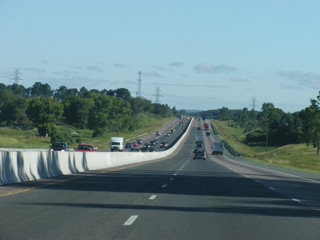

Jersey Kerb, when you hit it you tend to slide, though its bloody inflexible stuff!
