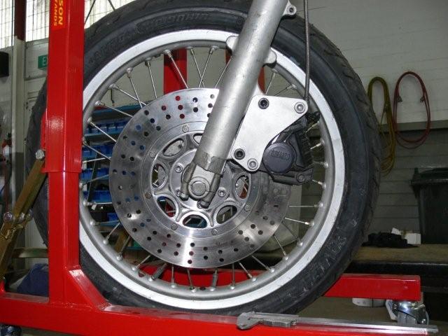

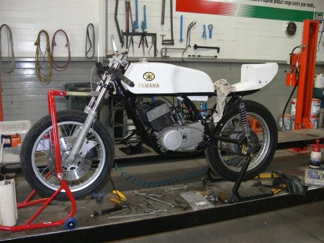

Playing this weekend . XS650 disc machined down for Brembo caliper .
Change of the tail section and different tank . My tank is coming , borrowed one for fitting pusposes . Also a bit of a weight reduction programme with a heap of lugs and crap cut off . Still had the steering lock on it :roll: Different ingnition sorted to get rid of the battery .

What a waste of a decent set of brakes. What you really need is some LC brakes. I'll swap you if it helps you out. :D

aardvark wrote:What a waste of a decent set of brakes. What you really need is some LC brakes. I'll swap you if it helps you out. :D
I know its a bit of a waste Ardy :oops: coz I wont want to use them if I want to stay anywhere near you and the rest of the SA Elsie boys . Some SA lads were at the Southern and they were quick !!
Will keep my eyes open for a Brembo if you really want one . Have another disc already . The cheap way to get alloy rims is to snoop around the dirt bike wreckers for the right size rim off the rear of trail/dirt bikes . Can be had for $30 Getting them respoked is expensive . Yamaha are a bit parts bin builders so its suprising what will fit on different bikes .

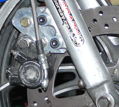

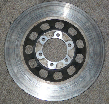

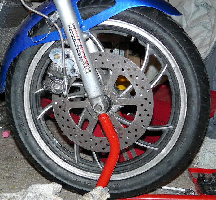

Fresh off the CNC is my new disc. Had to make a bracket to move the caliper out.... Hopefully the stock forks don't snap in half with all this extra braking force! ;)
The old disc - 267mm
old disc.jpg (103.18 KiB) Viewed 1485 times
The new disc - 300mm

Looking good Ardy :D Especially the way you have the brake line mounted , I really like that part :twisted:
Re: Anyone got their rule book??
thtas to stop the forks from snapping mate :lol:
Wattie wrote:thtas to stop the forks from snapping mate :lol:
Hahaha, exactly. The new disc caused so much braking power that I had to back something off a little. :lol:
