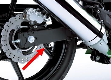

250 ninja swingarm.jpg (21.51 KiB) Viewed 2546 times
Re: Installing spools/rear stand
Posted: Thu Jan 22, 2009 11:02 pm
by IsleofNinja
Can't get much clearer than that thanks to Spex :kuda:
(use imagination re RED arrow on your bike (arrow not included on 250 ninja's :lol: :lol: ))
