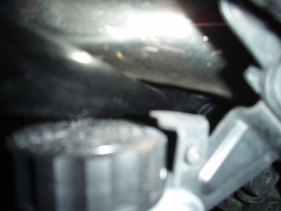

Just another quick question does anybody elses rack's touch the mid pipe on there exhaust? And could this potentially be an issue?...... :kuda:

Got a pic of the problem area?

robracer wrote:Got a pic of the problem area?
Shit Rob hang on I'll go take a Pic back in 5..... :lol:

OK on the right It touches the mid pipe and pushes it onto the rear brake master cylinder....That's why I can't get it to line up without a bit of GENTLE persuasion :shock: :lol: :lol:
Re: Ventura rack install?
leave it thats fine..... worst case you will melt the powdercoating where it touches ;)
