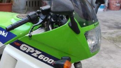

Spot on there Joe.... as I said in a previous post, something has gone astray, that bracket around the headlight does not look standard
the original bracket has mounting points for the fairing.... where the lugs are now floating in space

oh ok that wasnt the news i wanted but what do i do about it?? it all works fine do i just leave it of do i source anther park? what will i need and from where?

if it aint rattling and everything works fine and it shines a nice beam than you can just leave it, or you could get the bracket modified to have the headlight sitting in the right position... otherwise its just not consmetically correct...
i bet what has happened is that the bike has been crashed, headlight fitted while naked... ridden without a fairing and then had a new/repaired fairing put back on... the headlight position probably looks ok if you take the fairing off...

Here is a closer pic of how it should look.
- 203253.jpg (17.31 KiB) Viewed 4831 times

thanks so it wont hurt just to leave there as is till either it fails or i find replacment parts?? replacment parts id be after would be??? the front fairing?? light?? what and how much $$$

I doubt you need to replace the fairing - suggest you try to get the upper fairing bracket as it has the correct mounting points for the light (oh you'll need a replacement light).

No worries - the upper bracket is the framework the fairings connect to along with the rear view mirrors. It should also house the headlight - I'm guessing your one has been "modified" to ride without fairings (as suggested before). Shouldn't be hard to either replace or have someone weld up a set of brackets that will house the headlight for you.
