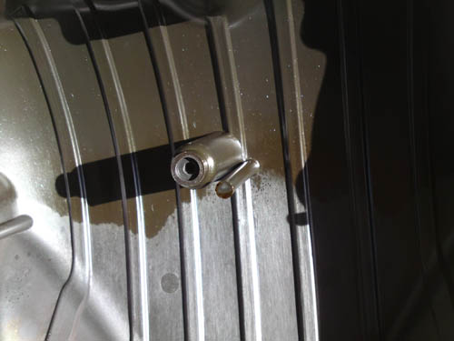

The wetness in the airbox is a wet film on the inside of the lid right above the induction ports. I will try and post a pic tonight.
I ran the bike connected to a car battery with no tank and airbox to run the fuel out of the carbs on Sunday and it sounded like it was 'spitting' back through the carbs.

A liquid?? Is it gas, water, Jim Beam? Try and find out what it is. Wipe your finger across the wet and smell it. If it's Jim Beam don't change a thing and figure out a way to collect it, but it's probably gas and you may have a needle and seat that is not shutting off fuel flow. I would do this logically, however, (like i've ever done anything logically) start by having a couple of shots then take a compression check. When you pull the plugs note the insulator colour. It should be from almost white to a nice tan. Keep track of which plug came out of which cylinder as one may be fucked and the rest ok, (an indication of which carbie or cylinder is fucked). Then check your compression noting each cylinders pressure. If you have one plug that is wet or black that means it's rich so the compression of that cylinder will read low as the excessive fuel will wash the oil off the rings and cause blow by. Squirt some oil in that cylinder through the spark plug hole and re check the pressure. If its ok then your valves are good. The rest is fairly obvious if all cylinders are low even with the oil your valves are farked. If they are all ok but one plug is fouled or wet it's the carb for that cylinder etc. etc. etc. It could also be a lean condition but I doubt it with the moisture inside the air box. If that moisture is water or anti freeze then we have a totaly different problem. If it's anti freeze, (coolant) it will taste sweet, don't swallow it though as it's poison, Keep us posted please.

That wetness - almost looks just like a bit of blow-back through the carbies to me. It looks to be on a vertical surface ?

By the way if you are blowing back through your carbies, your intake valves might be farked. It could also be a timing chain issue. The Jim Beam and the compression test will address some of that.

the surface in the pic the the underside of the air box lid, the wet side goes above the carbs, the dry side above the air filter. Fluid smeels like petrol, but after two days it still looks wet and I expect petrol would evaporate off. Valve clearence has not been done in a while, perhaps 6 track days, nor has be carb balance.

Gas sputtering back through the carbs is not normal. You might want to run a compression check. You might have smoked intake valves. It could be adjustment also. Too bad it wasn't Jim Beam.

Nb: The staining on the airbox lid is a combo of intake pulse 'reversion' or blowback through carbs combined with a bit of engine blowby I would say. Sorta thinking the engine might be getting a bit tired going by the pic perhaps? How many km?

Had a think about the airbox thing , prob is breathing a bit of oil but in a track situation you kinda expect it too a little bit . I think the 10's burn a bit on the track too!
