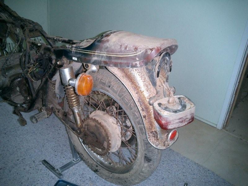

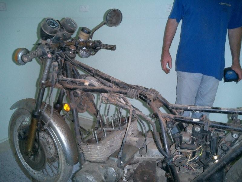

The bike sat on a fence out in a padock for 15 years....The shame of some people....... The man at the back is a good freind of mine and he found it for me....It cost me one box of beer? The pictures were taken 3 years ago

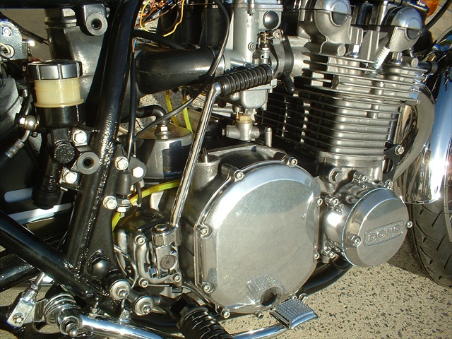

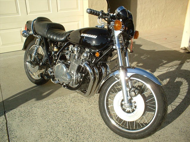

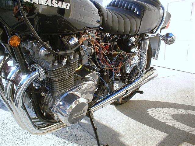

These are the only recent photos I had...But I will upload a recent pic when I can....
To a few hardcore collectors I would be slamed for not being original to form
- pipes
- colour
- seat
-bars etc
But..........The BONES are all their

Re: KZ1000A1 1977 CARBI PROBLEM ...HELP..HELP
Post by oldman »
What a beautiful machine. I'm very jealous. Glad your getting the carbies sorted. You should start your own shop. Keep us posted on how the carbie shit is coming. If in fact you have the wrong carbies it should be fairly easy to sort out but watch your spark plug colours as they will give you an indication of fuel mixture. If it's lean down low chances are it will be lean up higher as well. The main jets may have to be increased in size. Black insulators on the spark plugs=rich, white or pitted=lean and a nice Jim Beam lite brown perfect. This is very important on an air cooled bike as a lean mixture means high temperatures meaning burn't exhaust valves and numerous other engine top end problems. Pull them after a moderate ride, (not too long) and check the colour.
Lookin' good there matey :kuda:
Have to agree with the old man, that is a beautiful job that you've done with that bike, i am happy to see it and even a little bit jealous actually.

Hey Carbiez - looks great although i dont envy you organising those wires...
