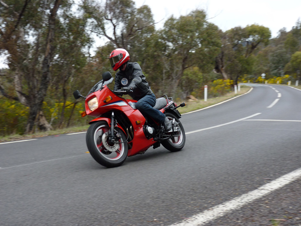

CR Wank Factor Ride today:
(Pic by Whickle)
Re: Goose
Top pic whickle, bike's looking great lurch, you win the prize for best helmet/bike coordination. :kuda:

Re: Goose
Post by Lurch »
Purely coincidence, I swear :)
The old beast still needs work - but at least he's looking the part now :)
