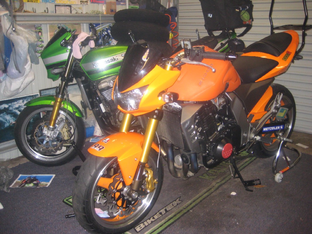

Re: Let The Mod Begin
This is how I went :D
Fark Yeah !!!! :twisted: :kuda: :twisted: :kuda: :twisted: :kuda: :shock: :twisted: :kuda: :x :twisted: :kuda: :lol:

She looks sweet mate, I reckon you sahould get the satin black on all the trim bits now bud, orange Zeds look smokin with the blacked out bits.
I just flicked a mail off to Mick about those smhick rotors, time for a spoil me thinks.
Give me a shout when you find out about the bolts and I'll probably get the same ones, States is farked for waiting. What length were yur spacers Phil 10mm?
Wattie dropped me a damaged 10 front guard, I may flop a carbon one off it, if I can find a couple of hours.
These Zeds can send ya broke :shock: but soooooooo much fun to ride!
Damon Z1000 wrote:She looks sweet mate, I reckon you sahould get the satin black on all the trim bits now bud, orange Zeds look smokin with the blacked out bits.
Nasho in the spring I think ;) Last time I was coming down I got a flat, then I set fire to the carnt :kuda:
Yeh, dont do the same again ;)
Spacers are 10mm, and I didnt get a chance to get down to Southern Fasteners, if I get a chance Monday I will and let you know, pm me your mobile no and I'll txt yo if I can get them ;)
I do like the blacked out look, am considering doing it to the rad and frame covers and the side panel. Then again with the Mrs just about to pop I may just sit back and ride for a while. :oops: lets face it, its not like I need to do anything to them
