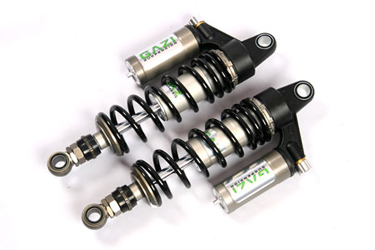

Just found this thread...I bought the bike with Ohlins rears and internal valves and cartridge fronts and have to say, the beast handles very well. With the hydraulic rears, as Phil said there is limited adjustment in compression, the rebound has full adjustment, but saying that the compression is very noticeable when you use 1 click (only 4 to use from soft to hard). If I had to buy them I would opt for Phils, much better in adjustment. Still when I need some more preload its there with a few twist and done. What ever you decide I think ya gunna notice a huge difference. :kuda:

Meanwhile I emailed Gazi last nite & had a prompt reply this morning from Paul Bushnell. He states T-Rex are using his equipment & the topline Hyper 750 units with 3 way adjustability are $780 a pair + shipping, with stock currently on hand. Definetly food for thought. Not real keen on the thread adjustable pre-load though, as I do change mine for varying riding & load conditions quite frequently.

A mate of mine has just ordered Gazi shocks for his new XR1200 Harley to replace the bloody awful stock suspension. Will be interesting to see how it compares. Bloody thing is unrideable standard. Waaaaaaaaaaaaaaaaay too hard and unforgiving. Niceish bike otherwise. :shock:
Price is similar to what you quoted. I hadn't heard of them prior to my mate ordering them.

Is the T-Rex you refer to Rex Wolfenden? :oops:
s man
Posts: 809
Location: Lake Mac NSW
Re: Two types of rear OHLINS for ZRX.
Post by s man »
If Rex uses them, I'd use em without question.

bonester wrote:Is the T-Rex you refer to Rex Wolfenden? :oops:
That would be correct bonester.
I only looked these up & contacted them based on the post by IanH earlier in this thread. Still not 100% convinced yet, but very interested.
