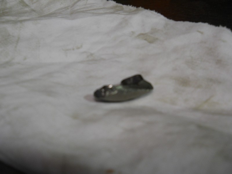

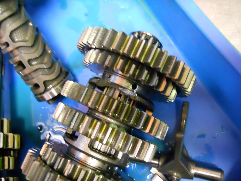

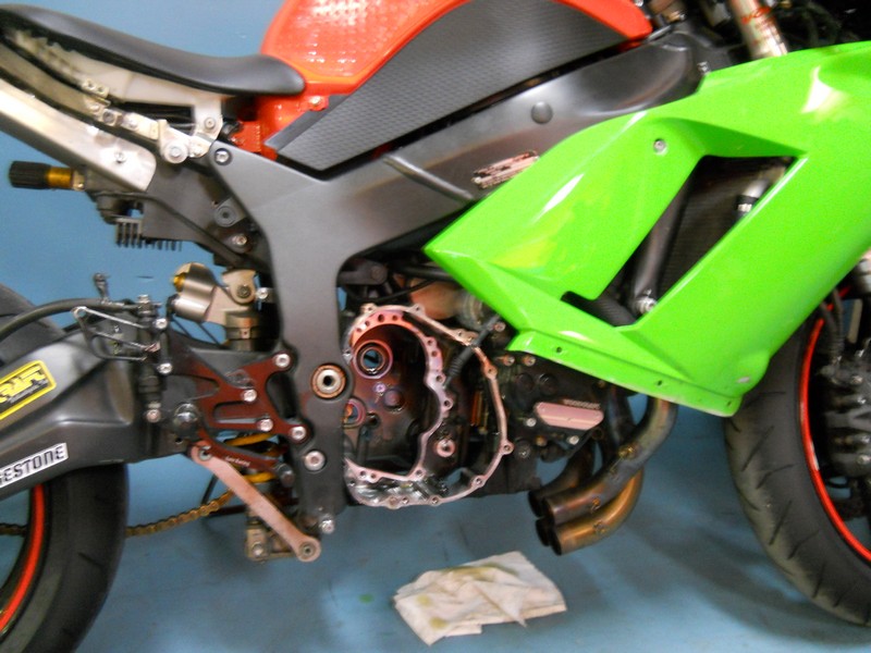

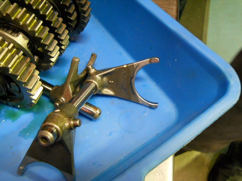

highsider wrote:sounds like a bent selector jon, not unusual for a track bike, see it all the time.
Correct, unfortunately :(
At Mc Park last weekend and the gearbox selection issues returned and finished the day off early.
It turns out I broke gear dogs off, selector drum is damaged, 1st, 3rd, 5th gears should be replaced and one fork shifter is bent. Parts $1k ex-japan 2 weeks.
zx6 box1.jpg (172.99 KiB) Viewed 4850 times
zx6 box2.jpg (172.03 KiB) Viewed 4850 times
zx6 box4.jpg (103.8 KiB) Viewed 4850 times
zx6 box3.jpg (160.66 KiB) Viewed 4850 times
I should have trusted my gut instinct weeks ago, but hey there ya go :oops:
Checked valve shims while we were at it, all good.
