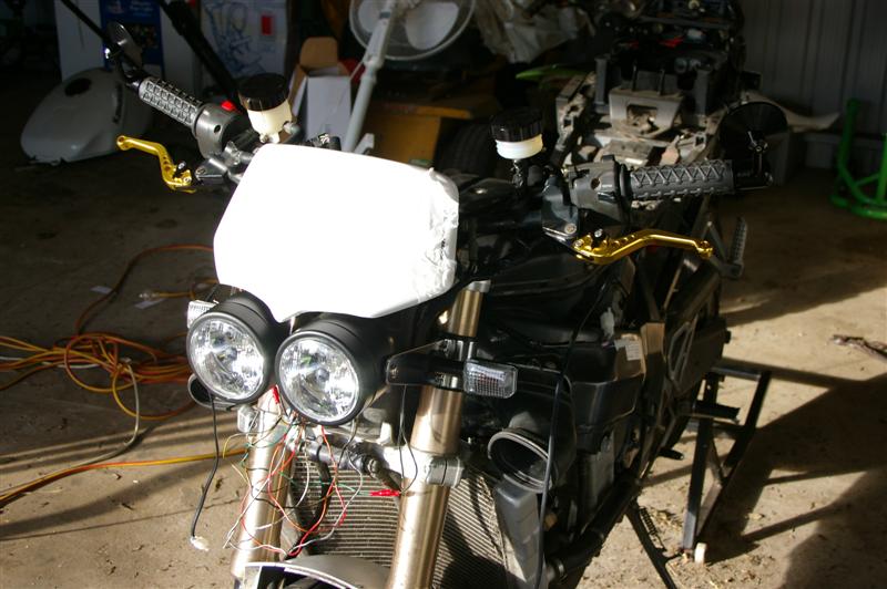

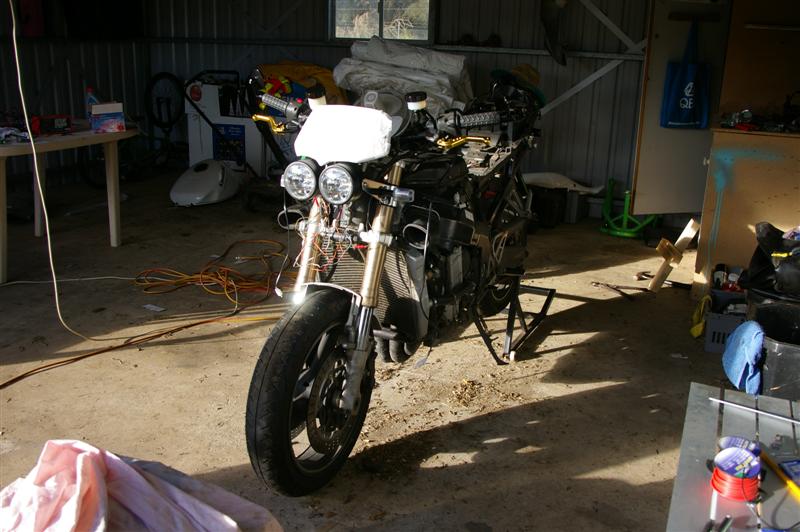

Spent the last two days hard at it. A mate came over to spend the day assisting and drinking my beer. :kuda: Actually realy got a fair bit done. The new risers and handelbars are mounted and the heated grips are also installed. The new chinese levers have been checked and put on. Bar end mirros also installed. The front end wiring has been shortened a bit and is ready to be tucked away.
The indicators are still being pesky and I might end up craking the shit and just re-wiring the whole lot to accomidate the independant warning lights. I did a mock rigging of the speedo and all the lights seem to opertate as they should but that will all be checked again when the time comes to actually properly install it.

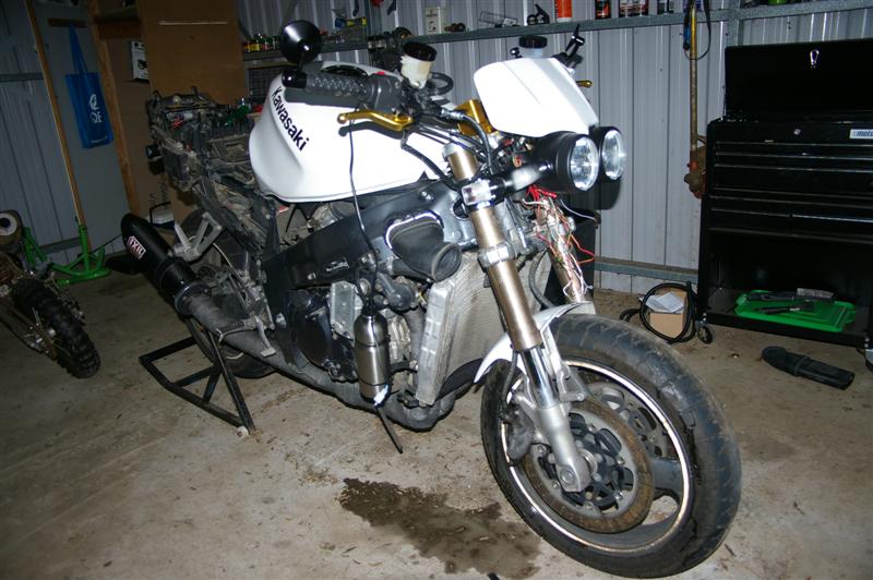

Here's some pics.
IMGP0075 (Medium).JPG (76.14 KiB) Viewed 3014 times
IMGP0074 (Medium).JPG (75.05 KiB) Viewed 3014 times
IMGP0079 (Medium).JPG (76.97 KiB) Viewed 3014 times
The radiator overflow is just temporarily mounted with zip ties for now so I could start it up. I'll be adding some sort of bracket off the radiator to mount it properly and maybe tuck it further away. Might not be keeping the bottle anyway.

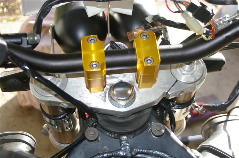

Also, how does the bar clamp attach to the top triple?
Negative on the internal memory. It's a digital slr so i'm guessing it just takes the sample pics for some reason.
As for the risers, the pictures that I haven't taken show the process for attaching where a friend helped me make up a nice template to measure and mark off a couple of holes. I made sure to buy risers that attached with a single large bolt instead of two smaller ones that way it would attach to the yoke without having the supports underneath getting in the way. Bolts go through and attach the risers, and locked them into place with a little bit of thread lock to prevent any incident.

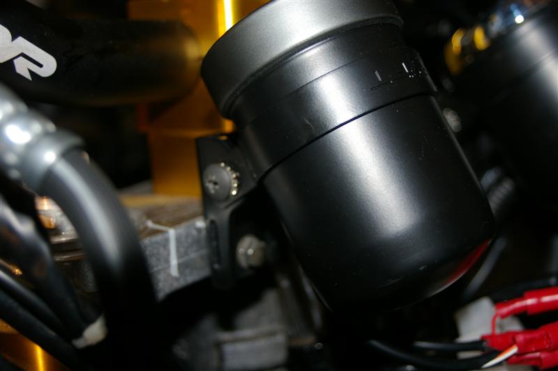

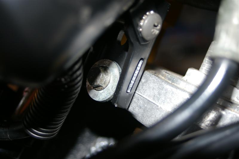

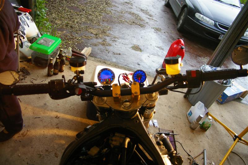

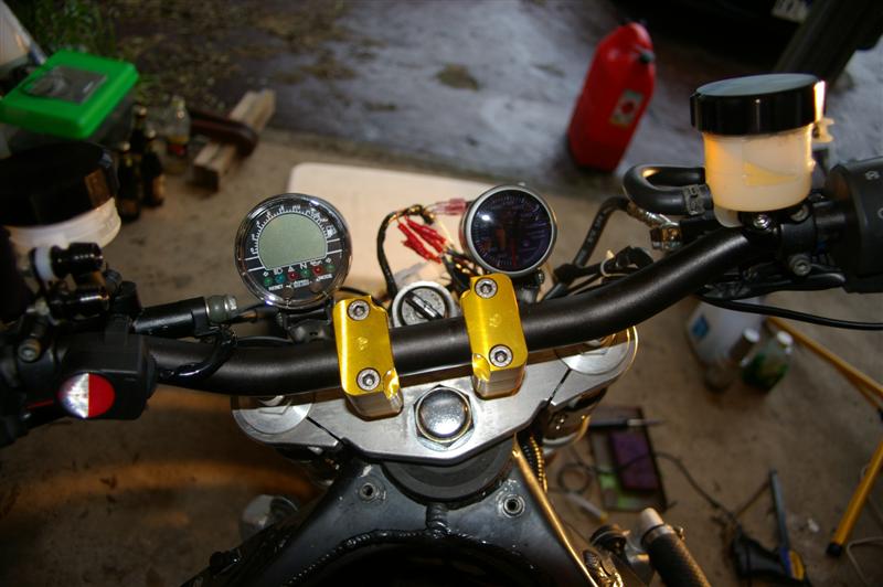

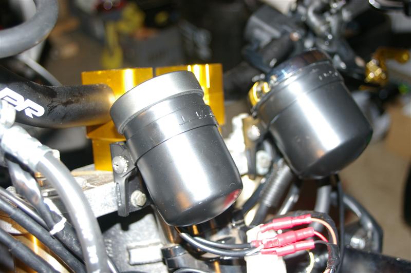

Here's the update. I've spent alot of time trying to clean up the loom at the front and finally made a little bit of progress. I got to the stage where it was time to wire the new gauges. Originally I was going to cut some sort of metal plate to make a simple dash board sort of thing but I happened to be in auto barn when I spotted some cheal gauge holders in the bargin bin. They were terrible, but it gave me the idea to look and see if there were any others that might be appropriate. I found two nice "drift" branded holders and remembered that there were already two holes drilled and tapped into the top yoke for the old fluid holders that they could be attached to. Score.
IMGP0094 (Medium).JPG (63.85 KiB) Viewed 2943 times
IMGP0095 (Medium).JPG (40.68 KiB) Viewed 2943 times
IMGP0097 (Medium).JPG (39.38 KiB) Viewed 2943 times

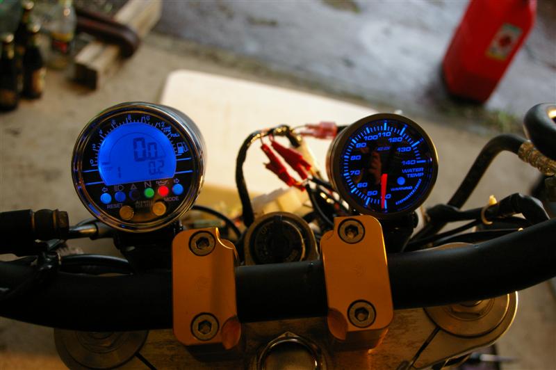

After i'd sorted this out I started to prep the wiring to attach the gauges. I wired them up and after a little bit of fiddling got them up and running and from what I can tell so far they are working correctly. Both of them light up well enough and I think they look the goods. :D
IMGP0099 (Medium).JPG (63.3 KiB) Viewed 2943 times
IMGP0102 (Medium).JPG (87.22 KiB) Viewed 2943 times
IMGP0101 (Medium).JPG (57.19 KiB) Viewed 2943 times
So now everything is pretty much wired but i'm having trouble actually getting the bike up and running :( I'll be putting that out to another thread though.
