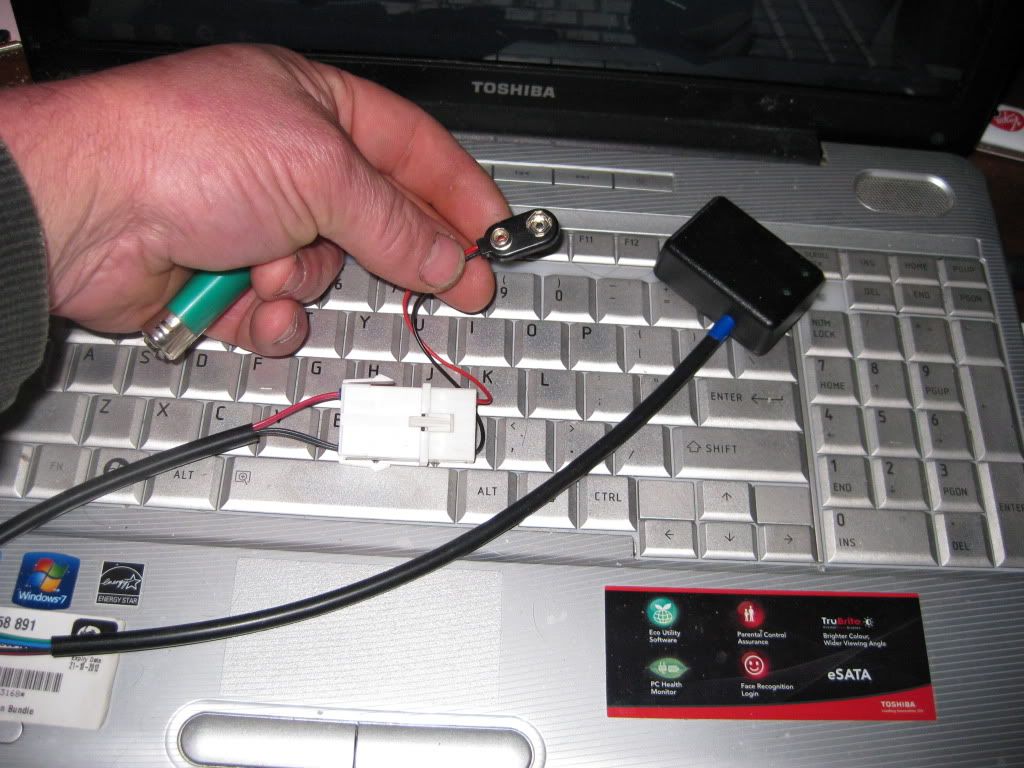

this is the key to make it all work + all the software!!

Madkaw doesnt have an ignition module. His seems to work...MAXUMIS wrote:this is the key to make it all work + all the software!![img]http://i821.photobucket.com/albums/zz135/MAXUMIS/IMG_0252.jpg[/img]
