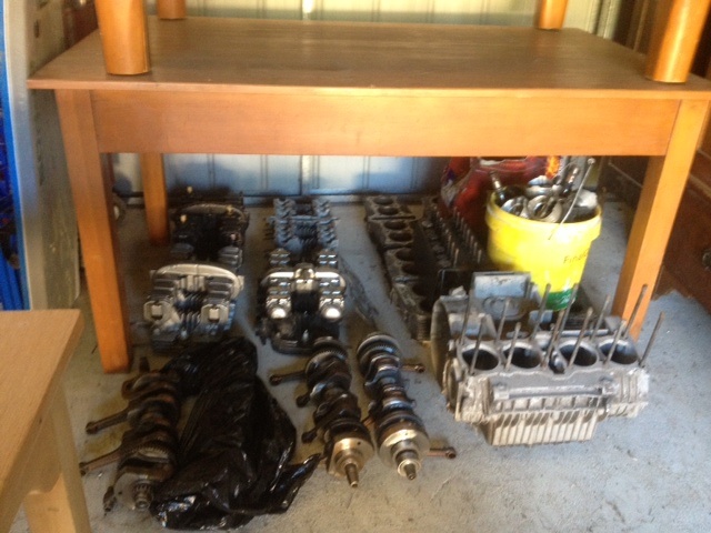

I bought an engine and a fair few spares to use for my rebuild off of a guy who ran a kz b engine in his sprint car so I am cheering as I have scored some great stuff!

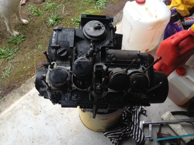

Below is a pic of the engine removed, must have been running really smokey for a while going by the carbon build up on the pistons
Re: B1 gpz1100 project
CATdoctor wrote:.....Oh and also, the spare cases that he had are Z1 E eng number but are in great shape compared to my KZBT case (original ) could I use this earlier case with my internals? Or should I just stick with the original case?
The GPz gearbox is different to the Z1E gearbox. You can adapt the GPz head to the early bottom-ends easily enough, but not do a case-change like you are suggesting - too many differences. Just stick with your original KZBT cases .....they are easy to split, and you can then give the cases a good detail.
Those pistons look normal to me - there is always some amount of carbon residue on any piston that comes out of a motor - those ones look totally normal to me. A large carbon build-up is one that you can measure with a match-head :lol:

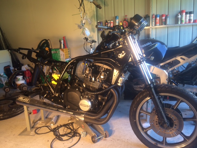

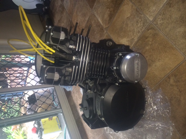

Well its been a really long time since I started my gpz project and I have not really progressed as far as I would have liked by now, due to numerous factors money, work.....lack of enthusiasim after swinging spanners all week for a job haha. The work completed so far- complete strip of bike back to frame, frame sent for checking and found to be twisted slighty and was straightened, frame and parts sandblasted and powdercoated satin black, engine I had stripped and rebuilt by a Kawasaki whiz in Brisbane bottom end checked, clutch plates cleaned up and heavy clutch springs installed, crank checked for alignment and found to be perfect, capacity increased to 1170 with wiseco pistons, head ports polished, all new valve train and ape cam chain tensioner, all new bolts and seals, painted satin black, I have fitted an earlier "DOHC" ignition cover and filed back the paint on the cooling fins as I like the look, have re-assembled the frame, swingarm and steering head with new bearings all around, have installed a new motobatt battery and dyna s ignition with 3ohm green coils and dyna suppression primary wires, currently in the process of creating a custom wiring harness out of a kz1000 harness in great nick.
Parts I have sourced for the bike and have not fitted yet are new wheel bearings, brake slave cylinder kits, forks seals, a really nice set of VM33 mikiuni smoothbores, a vance and hines drag pipe, a nice second hand set of marzocchi strada rear shocks and new rebuild kit for em, a set of superbike bars, a gauge set from a 83 kz1100 and still to source a round headlight still haven't decided if I will just stick to the standard gauge and headlight, new decals for tank and side,tail, a spare seat to convert to a elr.
So still making progress but slowly, am so keen to get the big girl on the road I think it will be a thing of beauty and sound like no other bike in the area.

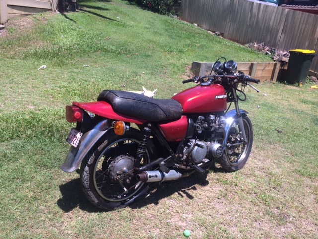

the Kawasaki bug has bitten, a B1 1977 z650 that I could not go past for the price. next project haha

lol at the 650 - sometimes bargains just have to be snapped up. Biggest issue with these models is the starter clutch - its internal and needs some tricky work to fix, if you want to do it without splitting the cases (which is the the factory method). If the starter clutch works OK - leave it alone. Sometimes a change of oil will help a sticky starter clutch as well......

cheers for the tips on the z650, unfortunately the starter clutch is slipping as well as the kick start cog!
But i put it in gear and turned it over by the back wheel and it turns freely with heaps of compression, the guy I bought it off said it has a 720 kit in it by the previous owner. I will try a oil change and see if the starter picks up. If not I will attempt the impossible keyhole surgery, can I get at the kick start clutch in situ or is it a split cases jobby? I plan on making this beautiful piece of Japanese engineering my daily rider, but it has to wait it's turn in line.
you can get at the starter clutch in-situ - but that requires the engine out of the frame, or the bike turned upside-down (like doing tyres on your pushie ;) )
oil has to be drained before either of these methods used. What you need to do is take off the sump and this allows you to get to the starter clutch without splitting the cases. Its quite a fiddly arse job but worth the effort. Keep the oil clean and changed regularly will help delay any more starter-clutch slip for a while.
