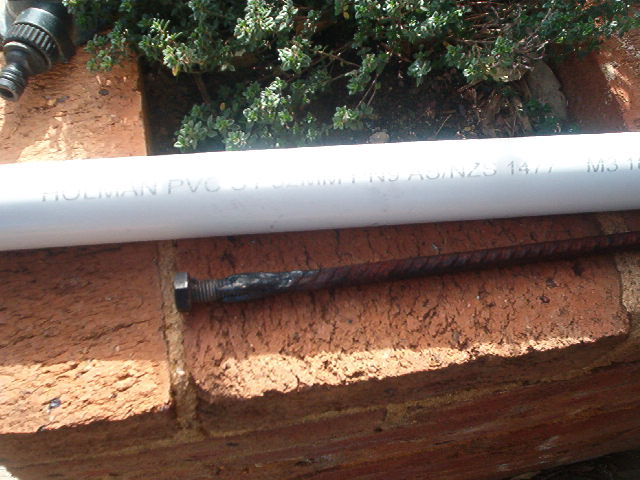

Done. Well one fork at least anyway.
Special tool and fork seal driver pictured below.
Now the next issue. This model has air forks but it looks like the previous owner has removed the o rings inside the balance chamber so I don't think it will be air forking any more. I'm gunna put o rings back in and see how they work.
