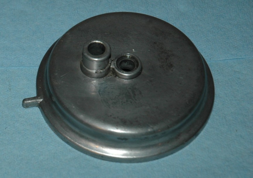

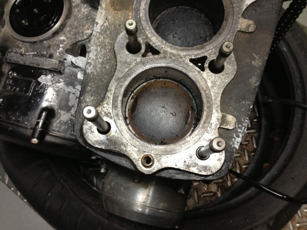

So, skip forward a step, and after last weekend the engine and frame have been separated - easy work when you have 3 faithful helpers who require only beer in exchange for muscle power :)
I'm relieved to discover that the crank turns freely, the pistons move up and down in their unmarked bores (a little carbon around the top of the sleeves, but I imagine that's normal), and I can't feel any rocking of the pistons in the bores (not sure if that's actually a valid test, mind you).
Piston crowns a bit oily, maybe it's an oil-burner ?
And this must be the original colour, under the breather.
A question for the knowledgable folk out there: is this discolouration around the exhaust cam area normal ? I"m guessing the motor has run a bit hot at some stage, and left a little burnt oil residue. Irrespective, a big oil cooler will be coming. Also interesting that there are a couple of grooves on the rear camchain tunnel - I'd imagine the camchain has run loose at some point.
The budget has stretched far enough for ebay to let me have a couple of bits this week, a replacement transmission cover and this neat lo-rise crankcase breather.

That discolouration around the cam caps - it has definitely run warm during its life. A good oil cooler will sort that. Once the bore size gets up much past 72mm, its always a good idea to run an oil cooler, as the cylinder liners start to get a bit thin and transfer heat a lot easier into the block.
