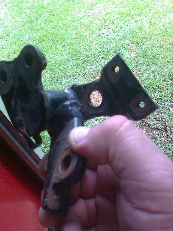

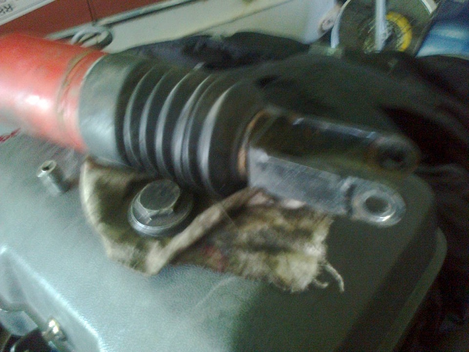

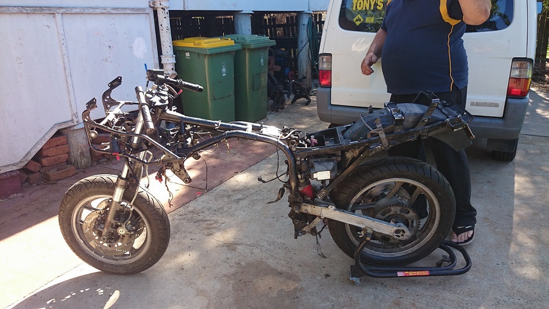

Photos are of engine removed to fix frame. Can see stupid extended rear shock in bike- wondered why centrestand wouldn't work. Can also see frame in background that donated sidestand mount- pictured below and rear shock modified. Standard shock fitted and centrestand worked miraculously.... :) No one in their right mind would repair this bike ordinarily....

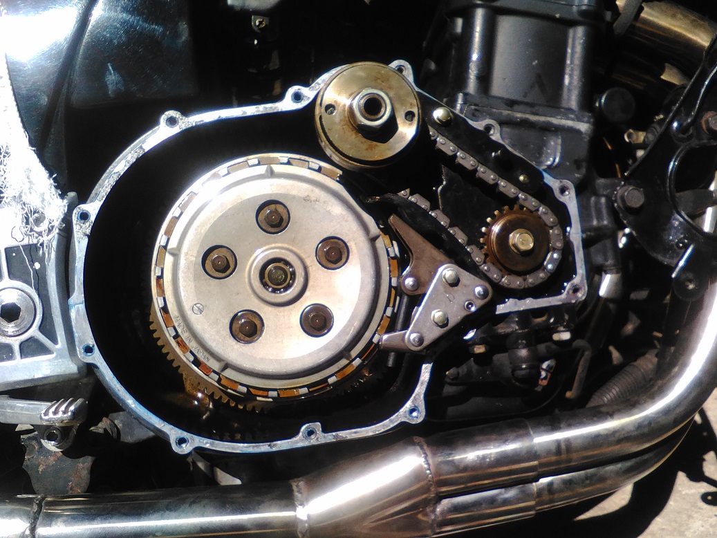

I also changed the starter chain. $72 for a genuine chain. Cheap investment coz when they let go they can cause havoc or even complete engine failure. Mine was banging like a bastard when I bought the bike- tensioner and chain were shagged. Put a slightly worn ZRX tensioner in when I first got the bike back.(chain is different) Manual says that you have to undo the bolt on the shaft with the cush drive- you don't. :) Pretty easy operation. Just make sure you drain oil first. On ZRX you can pull off sidecover on sidestand and not lose any oil. On GPZ it goes bloody everywhere. :(
