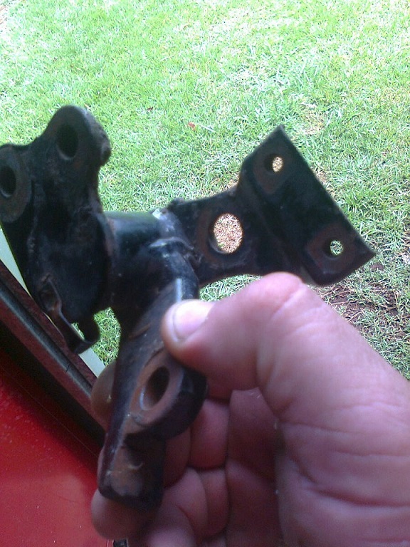

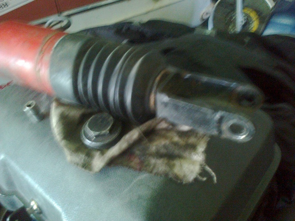

Photos are of engine removed to fix frame. Can see stupid extended rear shock in bike- wondered why centrestand wouldn't work. Can also see frame in background that donated sidestand mount- pictured below and rear shock modified. Standard shock fitted and centrestand worked miraculously.... :) No one in their right mind would repair this bike ordinarily....

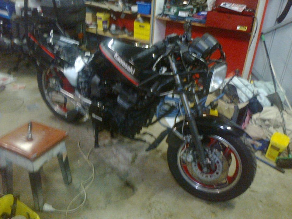

Bike work tonight. Removed full exhaust, radiator/ front lower subframe in anticipation of 4 into 1 that should arrive tomorrow. Had a lot of issues with the manufacturer. I hope he is better at making exhausts than he is at communicating and keeping to timeframes, and especially how he talks to customers. He was the cheapest option for what I wanted. Otherwise he could have worn the exhaust in a suitable orifice.
