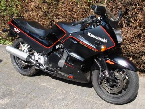

I have not been able to figure out why the small side-panels at the rider's knees is a different colour to the rest of the bike. Plenty of pics of these bikes on the 'net show the same difference. Doesn't make sense and looks a bit bodgie.
.. should be painted to match (as per mine)

Smitty wrote:.. should be painted to match (as per mine)
People around the world apparently do paint them to match,e.g.
GPX750R Dionne.JPG (37.34 KiB) Viewed 20773 times
but I have a different idea I may try first.
Re: GPX750R resurrection
naaah... they come from the factory that way (I did not paint that)
Mister_T
Posts: 205
Bike: GPx750
Post by Mister_T »
The main problem with the red/white is that it does not match my leathers. Also, I would not want uneducated people mistaking the bike for a CBR1000.

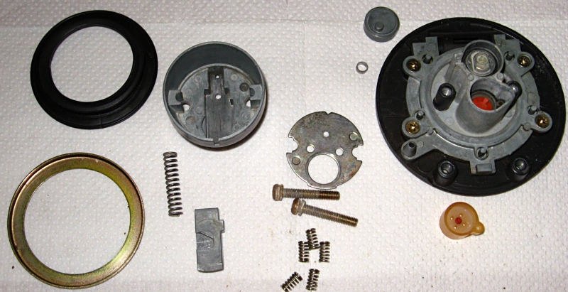

One thing that has bugged me is that the fuel cap has been difficult to open, no doubt some corrosion from the stale fuel has set in. The original key has a bit of a twist in it now. Some CRC down the lock helped get it open.
Once apart I used a plastic scourer to take the powdery matt off the alloy plunger and its housing. Works like a charm now.

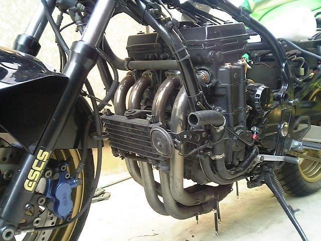

When I look at a pic of a Jap GPX with the radiator off and the headers nearly off:
Nice and clean!
Nice and clean!
I have to wonder how it will all go into the stiffened frame. It probably won't.
Kawasaki designers are no fools either. They did what they could with the goals and budget they had.
I'm sure Mr Foale did an excellent job stiffening the frame. It's just that a motorcycle is more than a bare frame.
Even if the engine fit in, the stock airbox would not, and I suspect that you would have to be on very good terms with an experienced tube-bender and welder to get headers to fit.
