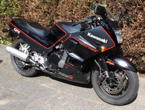

I have not been able to figure out why the small side-panels at the rider's knees is a different colour to the rest of the bike. Plenty of pics of these bikes on the 'net show the same difference. Doesn't make sense and looks a bit bodgie.
.. should be painted to match (as per mine)

Smitty wrote:.. should be painted to match (as per mine)
People around the world apparently do paint them to match,e.g.
GPX750R Dionne.JPG (37.34 KiB) Viewed 20774 times
but I have a different idea I may try first.

naaah... they come from the factory that way (I did not paint that)

The main problem with the red/white is that it does not match my leathers. Also, I would not want uneducated people mistaking the bike for a CBR1000.

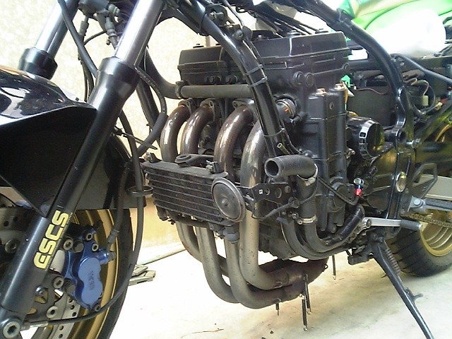

Cruising the net for interesting tidbits of GPX info led me to the website of Tony Foale ( https://motochassis.com/ ). That is a name which older riders with a technical bent will remember.
In one of Mr Foale's articles ( https://motochassis.com/Articles/Frame.mod/KawaMods.htm ), he describes stiffening a GPX750 frame, also describing the original as "super bendy". Mr Foale is no fool so that article caught my eye.
Here is a visual excerpt:
That is all well and good, but a frame needs to contain an engine and other parts.
When I look at a pic of a Jap GPX with the radiator off and the headers nearly off:
Nice and clean!
Nice and clean!
I have to wonder how it will all go into the stiffened frame. It probably won't.
Kawasaki designers are no fools either. They did what they could with the goals and budget they had.
I'm sure Mr Foale did an excellent job stiffening the frame. It's just that a motorcycle is more than a bare frame.
Even if the engine fit in, the stock airbox would not, and I suspect that you would have to be on very good terms with an experienced tube-bender and welder to get headers to fit.
Don't let this put you off reading Mr Foales's articles, he has plenty of interesting things to say. You don't have to agree with everything but if it makes you think a bit more about the design and operation of that collection of parts you trust your life to, that can't be a bad thing.
