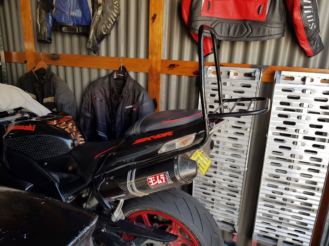

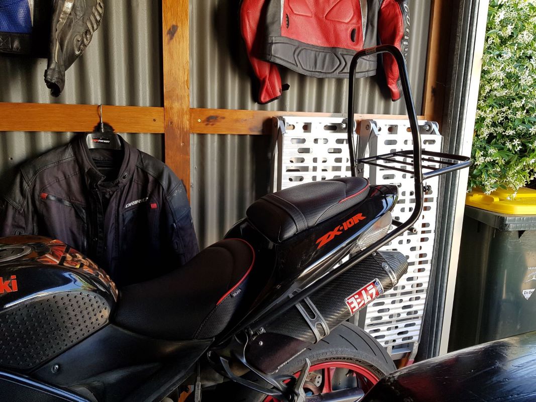

I usually turn my bag around onto the seat and leave the rack facing backward. works a treat

nice!! thanks for the pics, i gota do it.Kwakked Up wrote:I usually turn my bag around onto the seat and leave the rack facing backward. works a treat

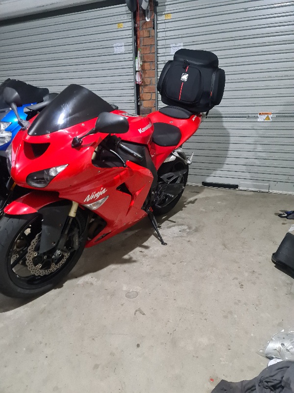

got my Ventura Rack sorted for ZX10R

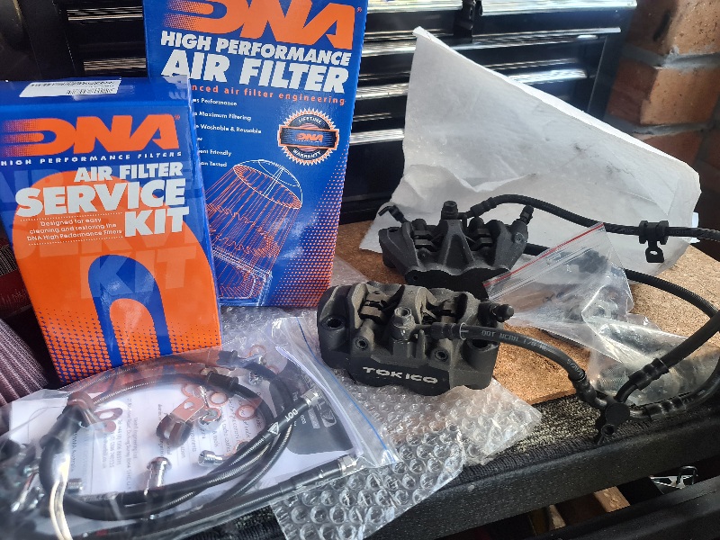

Got a DNA air filter

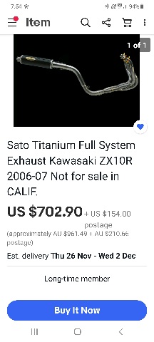

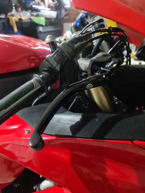

Got a Sato full exhaust system for ZX10R, hand made tuned titanium with carbon can coming from LA. Postage was wild, so i added the Brembo RCS19 adjustable master cylinder and reservior. Should turn up early next week.

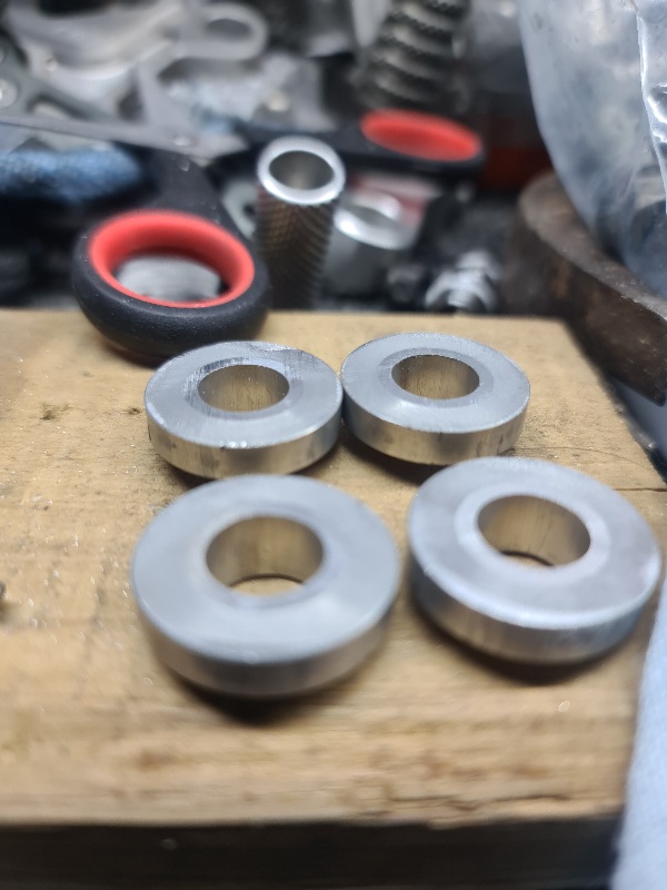

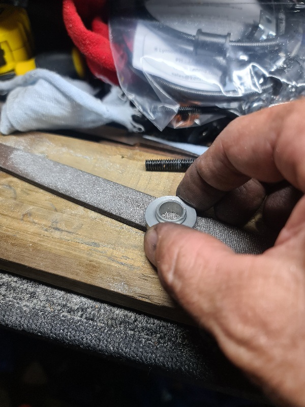

CBR1000 2011 monoblock calipers turned up. filed the dowl off 1 side of the spacers. Will fit them up when the MS arrives. Need to choose a pair of front pads.

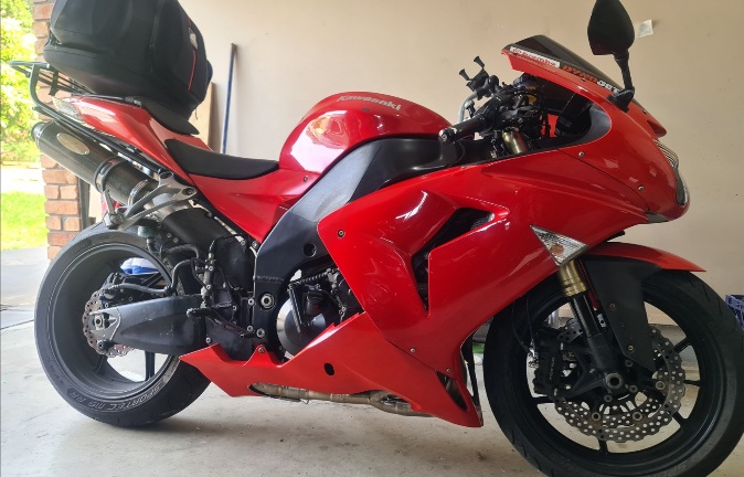

Brakes are done, amazing!!!
bike went well at Luddenham last Saturday

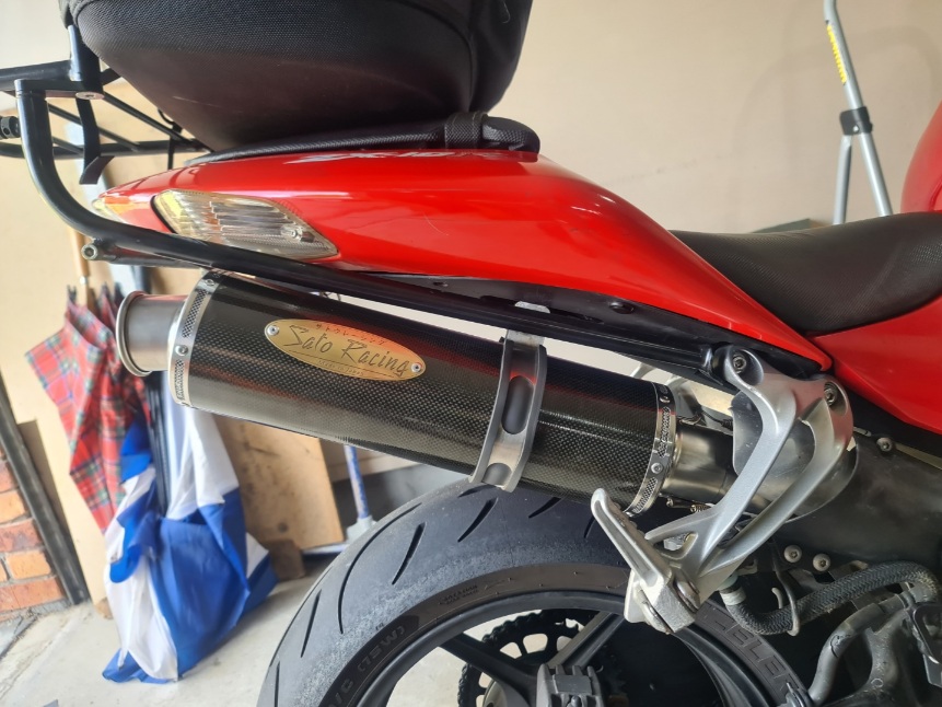

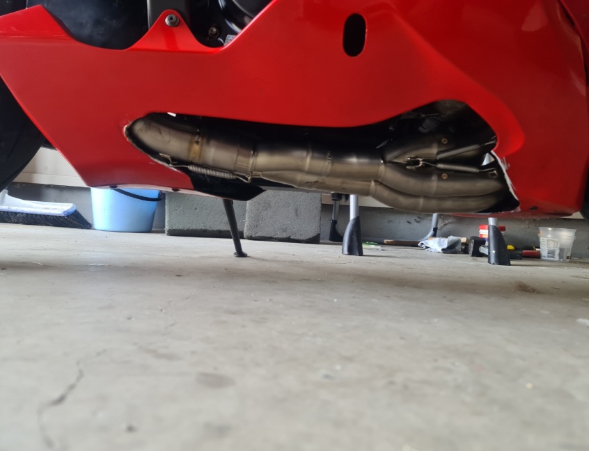

fitted the Sato full exhaust system last night.
Rode to work and back today. Massive improvement over stock headers and single 2 brothers exhaust. Nice deep note to the exhaust now. Noticeable extra power throughout the entire rev range, engine breathing easier during gear changes, lots more power in the mid range, top end is just crazy fast. I think its running cooler too. Had to do some trimming on the lower fairings.
The existing header pipes and into 1 section weighed 2.6kg, the titanium headers and 4-1 section didnt even register on the bathroom scales, felt like half the weight, other pipe and can similar with less weight.
Next stage is put the PC5 on and get a Dyno Tune

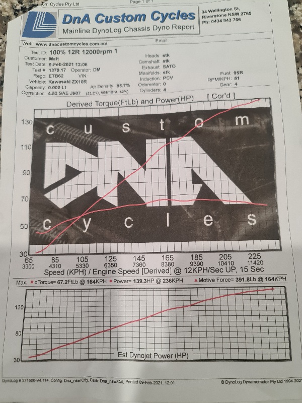

Dyno guy did well. Bike had BP 95 in it.
Bike was making 160hp and climbing. interesting that at the redline the rev limiter cut in at the indicated 13,000rpm, but bike was actually at 12,000.
Top chart was a run in 4th gear. Some of the runs where done under resistance, apparently not all Dyno machines can do that. The Sato exhaust has provision for an O2 sensor, so he used that for his sensor. I will post up a screenshot of the fueling map when i get a chance.
I rode the bike to work for the first time today after tuning, its soooo smooth and responsive, no more popping and backfire, power comes on early and just keeps building. Bike runs cooler too.
I have a 7 day ride coming up through the mountains on the NSW/Victoria border, looking forward to that now the bike is running so well.
