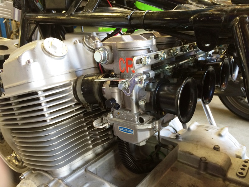

Well the CB750 is finally getting some TLC & work in the known problem areas, new front end is coming along nicely including twin Lockheed 4 fin calipers & thanks to Karl, a suitable master cylinder.
The new CR Round slides arrived
throttle hand is going to love these

Are those carbs adjustable in width to fit the different spacing (inlet spacing) on different engines? They appear to have bolts and a slotted bar that runs between each carb. if so would love to know what model they are and where to buy them.

Have brought a few sets of them from these guys over the years:
http://www.dynoman.net/carb/keiCR.html
The can also supply the jet kits & in some cases the inlet manifolds as well, they had this set delivered in under a week from the states, via post

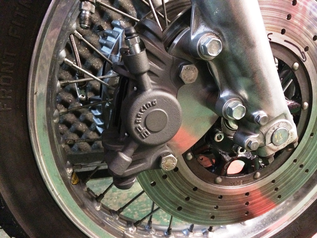

Time for an update, I have been busy with the 750, she has been fitted with a set of GL1000 tripple trees & fork legs to make room for the new brakes
I have had to make up disk spacers in 8mm aluminium & the caliper brackets in 10mm aluminium cut on a signage router, add to that the Grimeca master cylinder from Stevo & the conversion is complete!
I have re jetted the new CR carbs so all thats left to do is fix the tacho, paint the seat & tank & wire up the oil light & It will be ready for the chrissy track day, cant wait!

I bet it stops a bit better now.

awesome mate it will pull up great with that brake combo

those 4-fin Lockheeds are great mate, they pull up the 7/11 no worries
