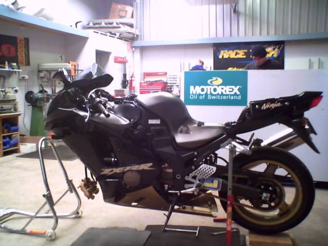

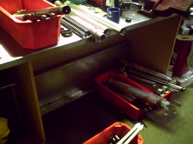

well Im finished at Racetech, and I've been for a ride, and f*%k me, the bike is awesome to ride now. The biggest difference is it remains toally flat through the turns with no for diving or squatting and it soaks up the bumps mid corner. It is a much firmer ride, but somehow the bike does less bouncing around, it is incredible. The front end feels so much more planted in corners. At one stage I got carried away in the twisties outside wallacia, and looked at the speedo, well fmd. He put a special nut on the rear shock that reduces front end dive under brakes and stops the bike squatting, and it does just that, Its feels great under brakes.
Terry was tops, when he'd fitted al the parts he told me to go for a run, on the initial run it was harsh, he said he knows??. Then he takes it for a ride and tunes it, then gives it back to me and it was silky smooth. He gave me a run down on how to adjust it if I need to, but said it will be fine unless I take it to the track, at which time I would wind up the preload.
If you do head out there, take your sandwiches cause its in bumf%#f idaho, but definitely worth the trip. Heck, it was nowhere near as expensive as I was expecting, good value IMO.
what he said to do to the 12 is, gold valves, new springs front and rear, shock re-valve, collar??, rebound separation valves.

and dontcha just luv how clean that workshop is........... :D
We cant all be short arsed welterweights....
