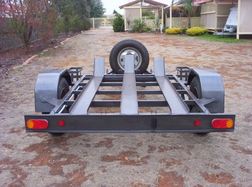

Its nearly finished , I need to take some more pics,
eveything except either some type of plate or open grid between the three U channels.
And then a final paint

I've been slack haven't I with the pics .
All finished except the final paint.
I'll work out a list of everthing then post a list of material used.
Oh and some pics

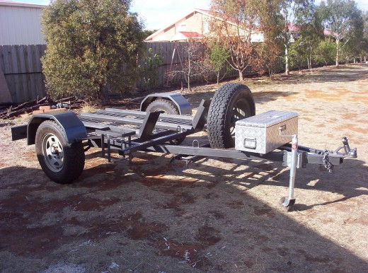

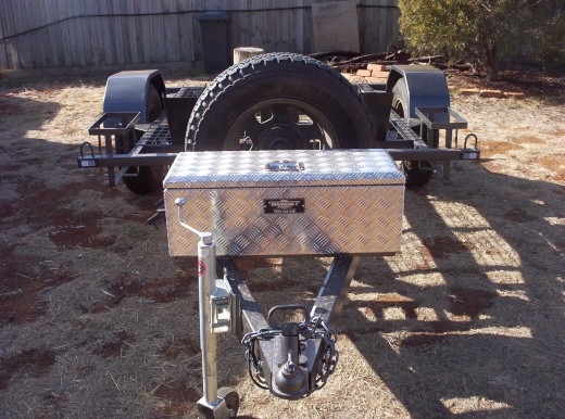

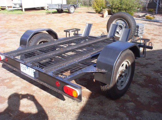

Ok here's some pics

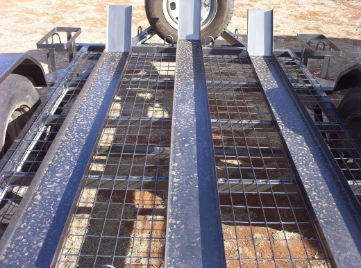

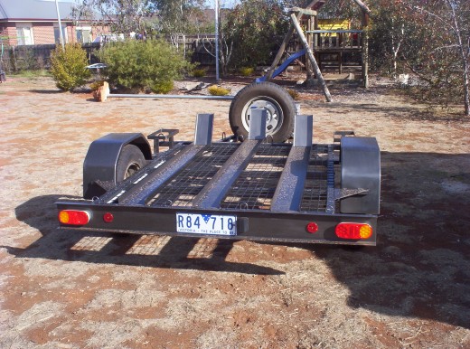

a couple more angles
