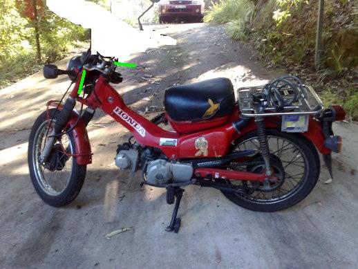

ty wrote:Where would I put the clip-ons? Wattie wanted them too.
Clip-ons would go on the top of the forks.
Forgive my lack of photoshopping skills, but something like this:

Posted: Fri May 15, 2009 8:32 am
by ty
Of course - dunno why I didn't see that :oops:
Looks like it's been done too, I'm unconvinced - but may try it sometime.

Re: evolution of a postie
Posted: Fri May 15, 2009 7:30 pm
by dave#3
I reckon the clip-ons look awesome and would seriously change the handling dynamics for the better I think (getting your weight lower and further forward). Do it!
