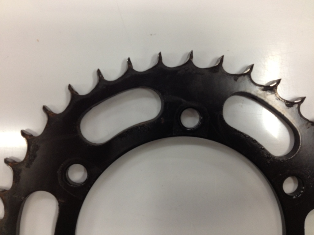

Some people just got no idea......
This came off a bike where the Owner said yeah the sprockets are good! I take care of my stuff he said
- IMG_2293.JPG (135.25 KiB) Viewed 36323 times
- Wattie
- Posts: 10043
- Location: Bligh Park
Re: ZX6R 05-06 Replacement Chain & Sprockets
Ouch!
