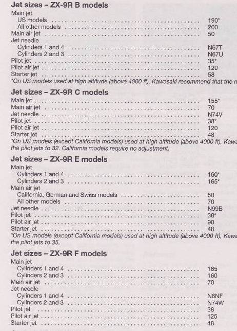

Here is a jetting chart I found tonight, and this may explain some of the big :shock: discrepancies I have seen on various forums and other places, when it comes to jetting specs......
Once I make sense of OEM jetting for a 9 and a ZX10/ZZR1100, and what Stage 3 specs for a DJ kit in a 9 actually are......I should have a better idea of what will be needed when I jam a bigger head and cams into this motor.

Post by laidback »
Here's the jet sizes from the manual...
ZX9 Jetting0001.JPG (71.8 KiB) Viewed 5601 times
Re: The 4th gets a new addition.......
thanks John, that's an excellent reference.
