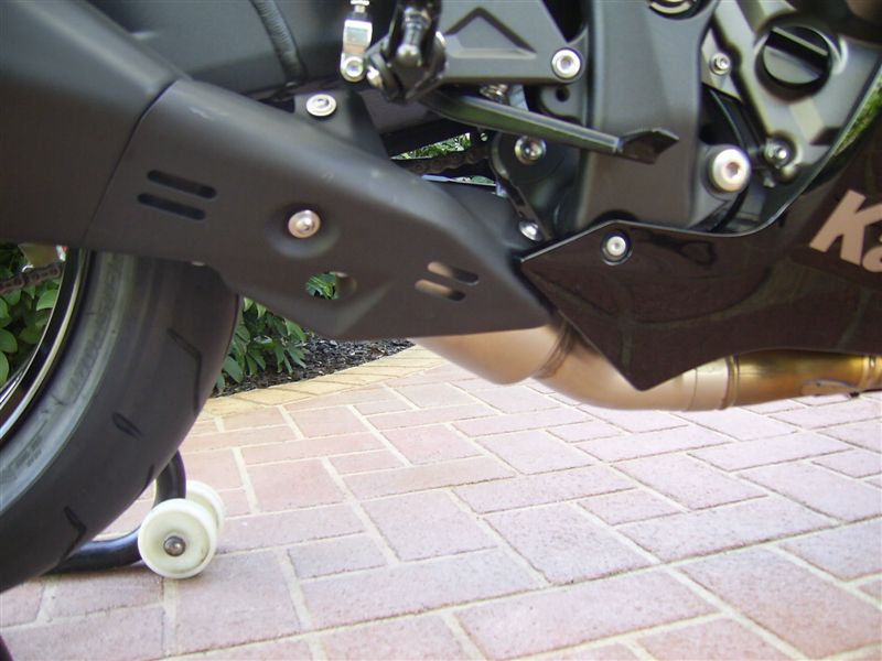

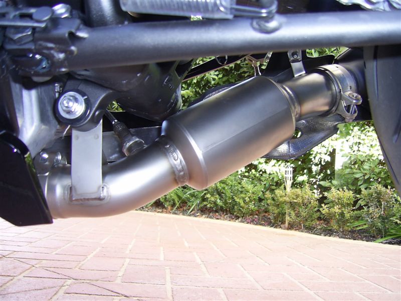

The titanium headers are supposedly very close to the 'race' model.. and finish up with the 4 into 2 into 1 with a 55mm main pipe... The Leo Vince Pipe comes off this and reduces further to 50mm which is pretty much standard... It goes through a small resonator on the Leo Vince pipe which really takes away the loud raspy sound you hear on some exhausts, then it goes straight through the OEM Muffler, which is also straight through and approx 50mm in bore, only that it has been made sort of rectangle outlet. SO it is basically a standard performance exhaust system..
I do find that with the titanium headers and stainless steel muffler it does have a bit of a 'metallic' ring to it, but still sounds nice.. but not ridiculously loud. I have fitted the other Leo Vince Carbon muffler, and that does make the tone a lot deeper, a bit louder because the muffler body is smaller.. but I am sure performance wise it will not make any difference to what it currently is now...

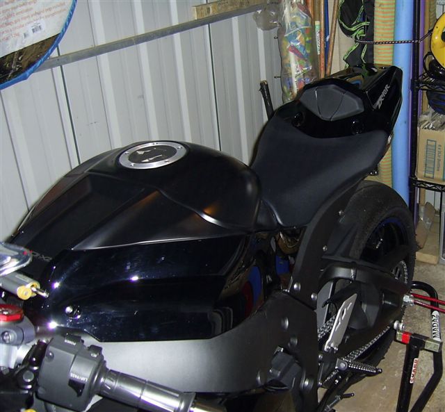

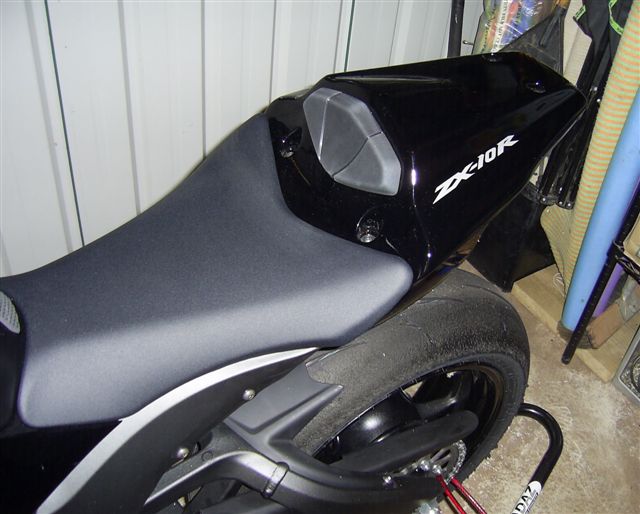

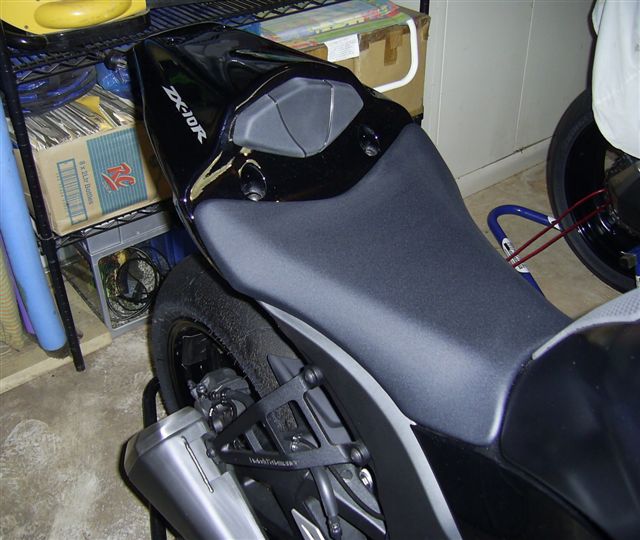

Ok, some more work done on the track bike...
As the seat is very long on this model, there is heaps of room to slide your butt back.. maybe too far, so I decided to fit an official Kawasaki seat pad to add an extra 20mm to the rear and also tidy up the look of the normal race glass tail section..
So here it is all fitted up.. A very fiddly job to get right, as you have to make up a cardboard template before drilling the 5 holes required for the mount.. anyway.. it is all done and looks great.
Will be picking up the 'Woodcraft' rearsets this arvo and building them up (got my locktite ready !!) and fitting them also ASAP.. so more pics to follow.. also have a set of 'Speigler' Braided front brake lines coming as well.. hoping they will arrive end of next week..??
Macca..
Macca..

That seat stop you installed, is that the stock Kawasaki from the rear seat cowl kit?

Hey,
Yes the seat pad is from the OEM single seat cowl, but obviously fits perfectly on the race glass, and looks very pro..!!

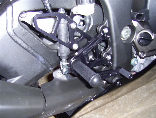

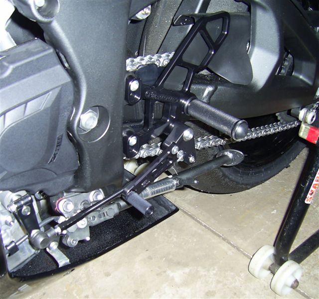

Re: The Build up Continues... New Updated Pics !!

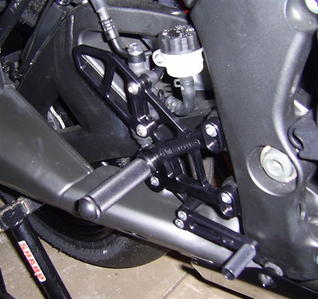

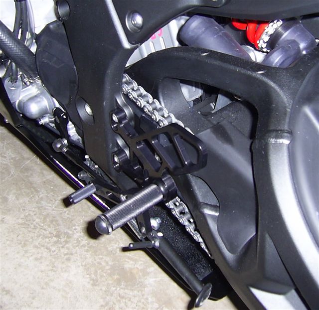

OK Rearsets now fitted...
And they fitted up perfectly. I really like the Woodcraft rearsets as they sit in nice and close to the bike, no ridiculous offset, and they feel very solid.
I have set them approx 10mm up and 10mm back from stock, as I quite like the stock footpeg setting (on the highest setting). I can always move them up an extra 10mm if required, but I will see how they go from here.. Now just waiting for the braided front lines to arrive...!!
Macca
