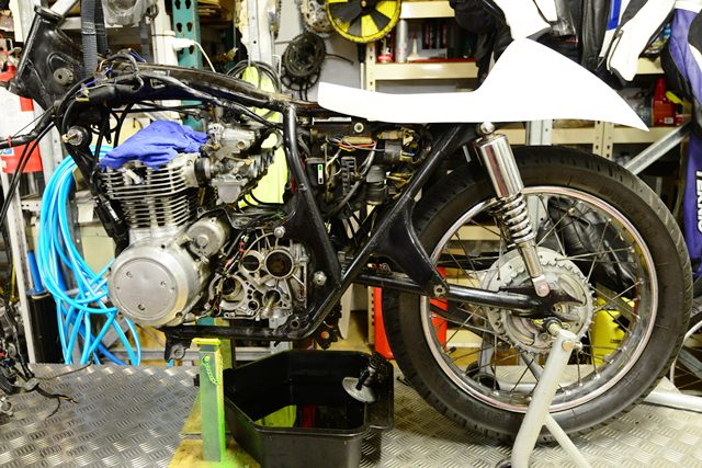

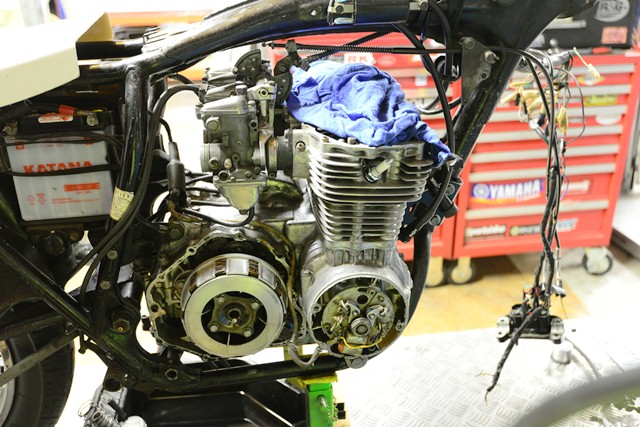

So the update...... seat is from Hand Craft FB, it will need to be upholstered to look period & especially to gain more height as I will be running Billet Joker Rear sets from the exhaust mounts...... the perfect spot!
I have ordered a fiberglass long tank from the UK which should be 1/4 the weight of the steel original
I will be changing from the contact Breaker points to a Dyna electronic ignition & Dyna coils, I also have some Barnett's clutch goodies coming from the states.

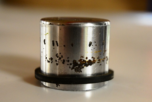

As can be seen from the Pic I will need to replace the front Calliper piston, the previous owner was a bit of a butcher
I think every bolt head is rounded off & all the Philips head screws required the use

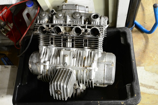

of an impact driver to remove, they were all farked! Motors will be stripped in the next few weeks & all alloy parts will be going off to Campbell's Classic MC for hydra blasting (seriously the best method!) forget soda forget sand HB works
so well & with absolutely no changes to tolerances as its gentle. have a look at Col's site: http://www.campbellclassicmotorcycles.c ... asting.htm
Front forks are being re chromed & I have a new headstock on its way as the original was stuffed..... lots of parts ordered like full gasket kits & oil seal kits MC rebuild kit, nice set of pipes and so on... my head is spinning!
Have done heaps so far with the removal of brackets & all unwanted parts but I'm in a holding pattern with the frame till the tank & seat can be fitted up then I can continue.

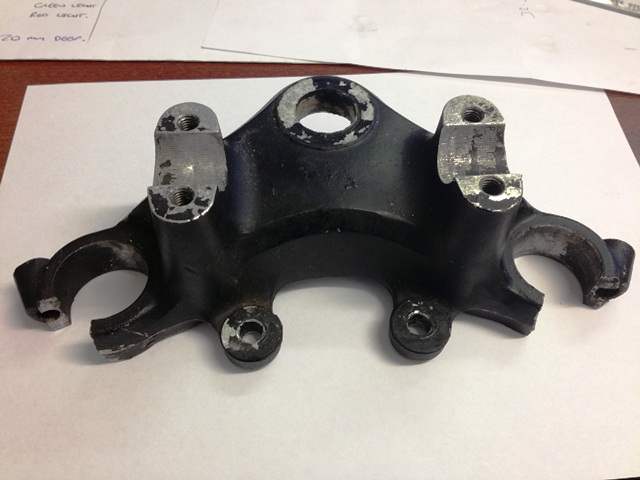

This is how the previous owner was riding about, not one but both top yoke fork leg clamps busted

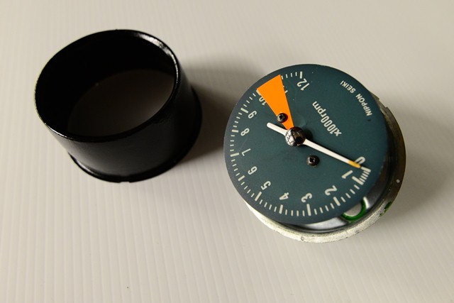

Seeing the Guage reminded me I should let people know, my cousin is an automotive gauge builder/repairer in Newcastle. Can't vouch for the company but she's really cool

Would have been a little Sloppy.robracer wrote:This is how the previous owner was riding about, not one but both top yoke fork leg clamps busted
Unless it was all seized on?
