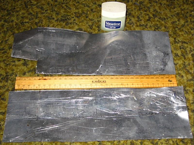

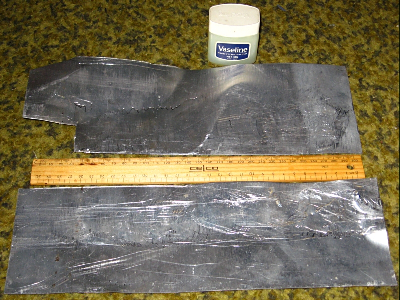

javaman wrote:Any chance to describe this magic tool of yours?
I would show a pic but I don't have it here at the moment.
javaman wrote:is it just a plate you force the carbs/boot into?
2 plates actually. One plate goes against the engine boots, one plate goes against the airbox boots.
I dug up some sheet aluminium and cut it with tinsnips. Each piece is about 35cm by about 15cm, maybe 1 or 2mm thick.The dimensions are not critical. As long as you have enough to cover the boot holes and have enough left to grip the ally with vice grips or mole grips or similair, you are on the way.
It helps a lot to have an assistant. Shoving the carbys between the sheets take effort and you will need someone to hold the bike and/or help keep the sheets in place. You are compressing the boots on both sides. Some lube in the form of rubber grease or vaseline on both sides of each sheet helps a bit but you will still gouge the thin ally sheet a a bit, but so what.
Once the carbys are located, pull out one sheet at a time while holding the carbys in, and the carbys should drop into the boots with some minor adjustments.
I won't claim I invented this technique. I probably read it somewhere and it came back to me when the situation arose.

This is the carby installation tool in all its primitive glory. Ruler shows size.
It got a workout and survived to do it again another day.
The cutout in the top sheet is not important. It was already there when I cut a single sheet in half to make the two.

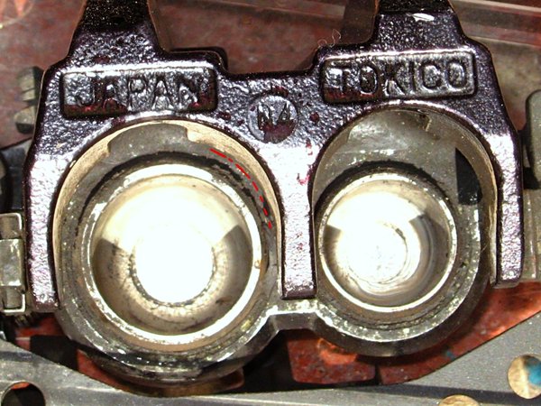

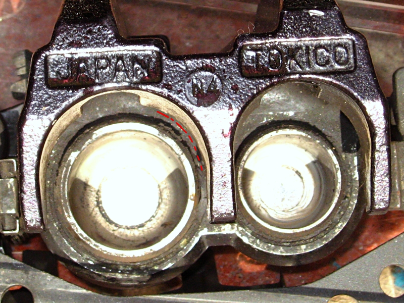

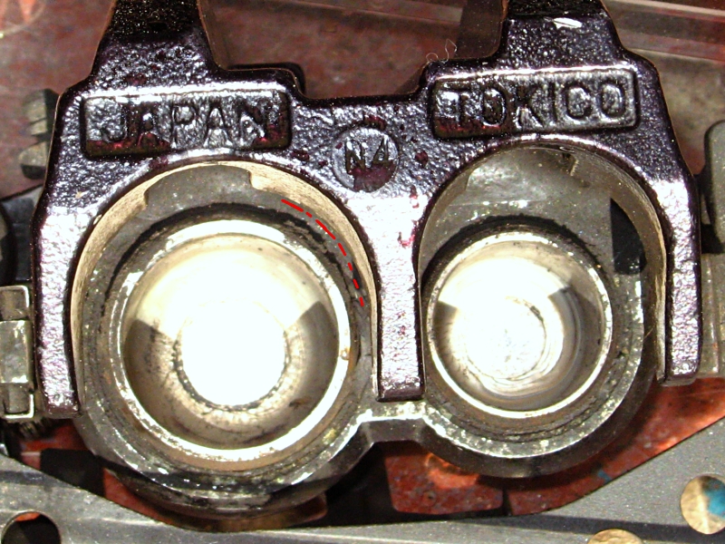

I took a pic of the caliper I swapped out.
The pic did not come out as good as I wanted.
Where I have put the red line there is a length of dust seal sticking out. This is probably why the RH disc is 0.2mm thinner than the LH disc. That dust seal is probably wedging the piston against the bore and stopping the pad retracting properly when the hydraulic pressure is off.
It is fixable but it was more expedient at the time to swap out the whole caliper. I will likely have to G-clamp the small piston and apply some hefty air pressure to get the big piston moving.
I was reading a post on some other forum somewhere, where a GPX750-owning poster described what seems to be the same issue. Is this something these particular calipers can do? I have not seen this problem before.

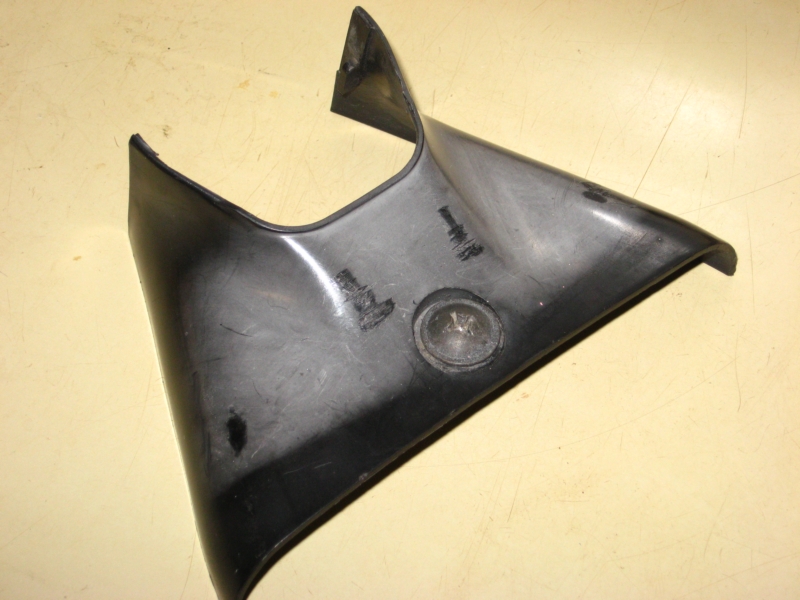

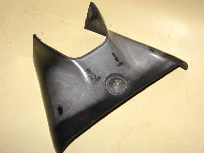

This is part 14024-1416 COVER, HEAD GUSSET.
A bit weatherbeaten, isn't it?
The aussie sun has not been kind to this plastic part.
So, to getting looking nice, the following steps were taken:
Scuff it up with a plastic scourer
Then:
Applying this should help the process along
Get it wet and wait a bit:
A bit blotchy, should have cleaned it with wax-and-grease remover better

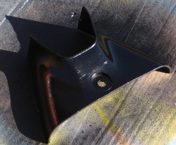

Light coats of colour:
A few light coats should do it

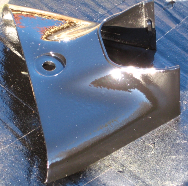

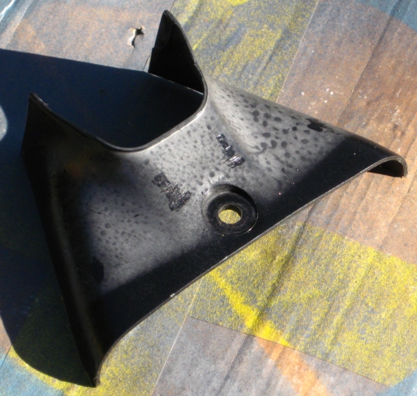

Whoops, too much orange peel:
[sigh] Not quite right

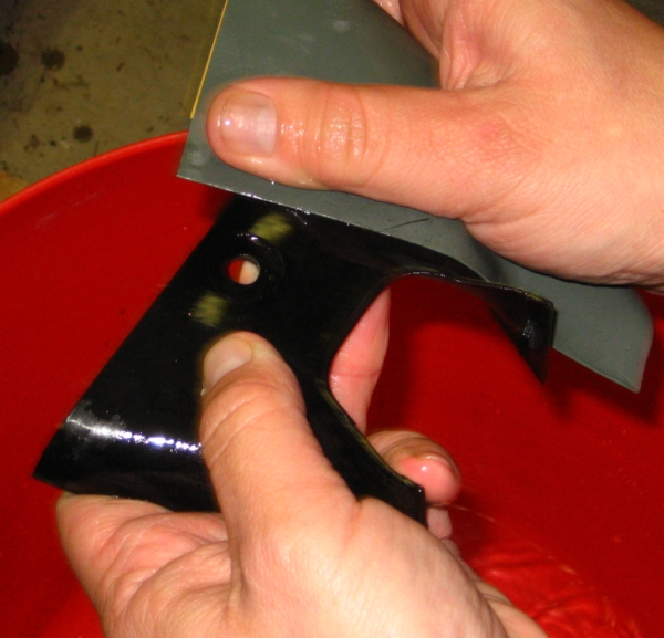

Rubbing it down with wet P2000 wet-n-dry:
P2000 should do it
P2000 should do it

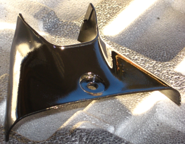

After a final light coat of paint:
That's more like it
That's more like it

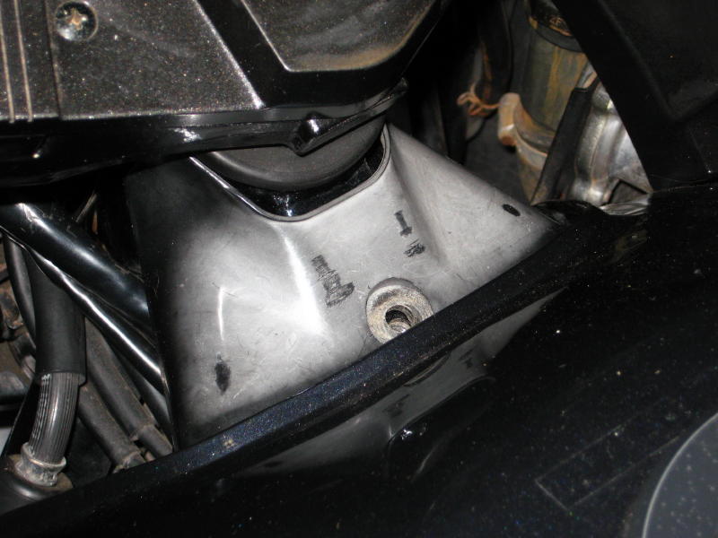

Before:
Hmmm, looks a bit neglected

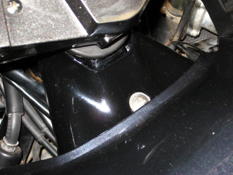

After:
Much better
Much better
I could have gone with satin black paint which may have given a slightly more authentic finish. No biggie, I'll see how I like the gloss, It would not be hard to change it if I want.
Ah, but what about that screw? It does looks a bit secondhand. I'll cover that in the future.

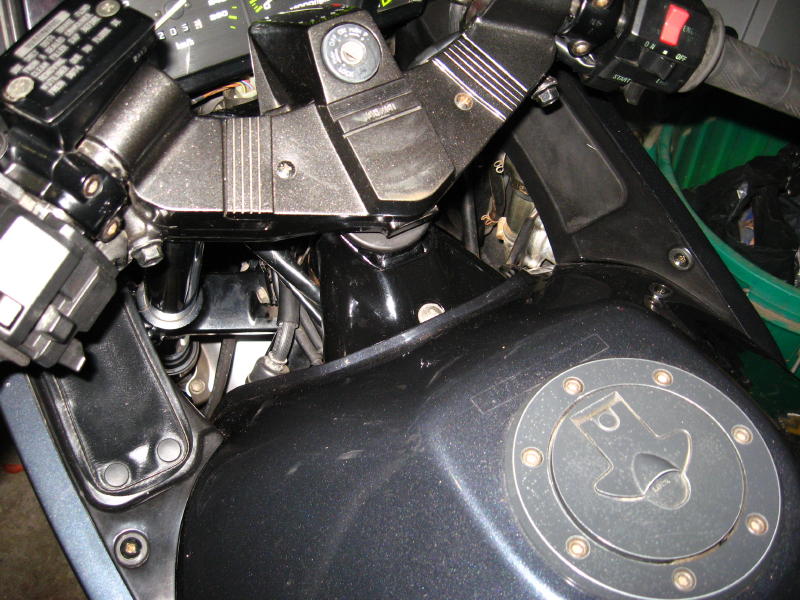

A wider shot for the full effect:

javaman wrote:I've been thinking of painting plastics myself! But a bit worried I would ruin it.
Practice makes perfect. Plastic primer helps. Since most road bike plastics are fairly stiff (and hence brittle) you can do without the flex agent in the paint that is used on things like modern car bumpers.
javaman wrote:I read that you can use a hairdryer to 're-blacken' plastics... have you done anything like that?
Last I heard this technique could be used to reduce the severity of scratches on the surface, particularly on softer car interior plastics. In my case, I doubt that heat would have made the same impact as paint did on the Cover,Head Gusset.
Even if heat does work, I suspect that heat is trickier to apply than paint. Imperfect paint can be rubbed back (as occured in my post) and done again. Damage from excess heat might be irreversible.
javaman wrote:I might try it in a hidden location just to see.
There are plenty of plastics on our bikes which the factory painted with 80's paint technology.
Practicing refinishing is one good reason not to throw broken panels and parts away.

Smitty wrote:.. never had this issue with my GPx7fiddy
Ok.
With the number of other Kwaks using the same caliper, including the very popular GPX250's, some sort of reputation should have surfaced if a design flaw was the case.
It would be sort of nice to think that it was not the result of somebody replacing the seals and leaving a couple of centimetres of dust seal sticking out and saying "fuck it, too hard".
Still, when I pull apart that caliper I'll measure the distance between the dust seal groove and the end of the bore. Perhaps the combination of an out of limit disc and worn out pads could allow the dust seal to peek out of the bore. New pads for these don't have a lot of meat on them to begin with.
