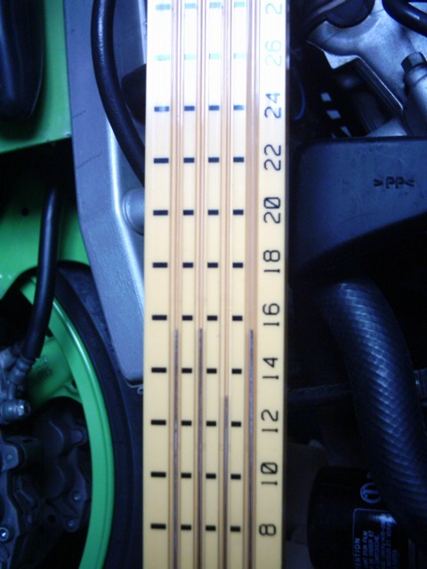

We checked the carb balance first...
Or should I say carb UNbalance...

I balanced mine at about 12,000km. They were a fair bit out. Being a slackarse, I then didn't touch then until I got my Carbtune early last year. They needed a slight tweak.
They haven't budged in the 15-20,000km since.
I'm really starting to get tempted to skip a carb balance check the next time I've got the tank off.
I-K wrote:I'm really starting to get tempted to skip a carb balance check the next time I've got the tank off.
If you haven't got a rough-ish idle, then you probably could overlook a balance - 15-20k is not *too* long a gap, Dans had done nearly 30k :shock:
Having said that, I only ever balanced the butterflies on the z1000 every couple of years anyway ( no slides, I love DFI :lol: ), and they only ever need a *slight* tweaking......
bloody carburettors are more trouble than their worth :wink:
that balance on the 6 in the photo is not too bad anyway, its only #3 carb that is slightly out of kilter, and I reckon the idle may have been *reasonably* good anyway ? Still, always good to get the balance just right. :D

Got back from a test run not too long ago - carbs balanced and she's running smooth as. I'm pretty sure she's fixed and good as new.
Will be definite after Monday morning's blat up and down the old road, but pretty certain she's all sorted. No surging and throttle response is much more fun.
Many thanks to all for suggestions - this thread taught me a bit and also got me very keen to start doing my own servicing, and a huge thanks to Mark for bringing your equipment and helping fix the bugger! I owe you one.
