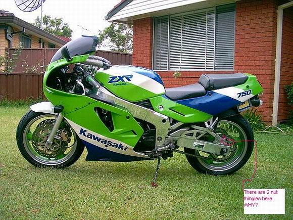

Also, if anyone knows what the 2 welded nut thingies are on the swingarm on left hand side, (see pic) are for please help.

Go right ahead mate, no worries :D Can you give me some info about the rotary tool / policher you bought today? Ive been looking for something to polish my shiny bits with.
Those little thingies are for the end of the chain guard Im guessing. Like this one:
