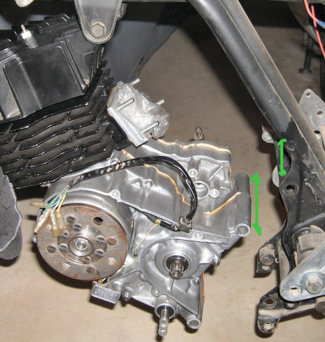

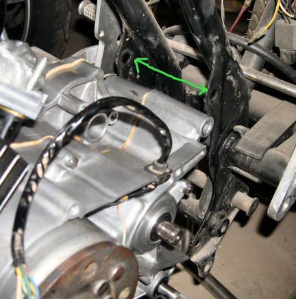

The bloody motor...
After having just rebuilt it, I decided it was time to fit it in the frame.
Put the first mounting bolt into place, swung the motor up and.... Damn, bloody second engine mount is all wrong. *sigh* As you can see in the pics below the bolt hole, which is cast into the engine case, was too long. Considerably so!
So, how to fix it? Out with the hacksaw. :lol: I chopped the end of the bolt hole on the engine off and the sucker fit into place. I had to drill the holes in the frame out a little to get everything to line up, but it sorted the middle engine mount out.
The third and lowest of the engine mount on the frame didn't line up either. Turns out I have a H100A motor and a H100S frame, which are obviously not really that compatible. I had to take an angle grinder to the frame and remove a spacer from the frame, then redrill the bolt holes in the frame.
In the end, a rubber mallet and some elbow grease sorted it all out.
The bike is at the exhaust shop at the moment and the bloody thing should be completely together by the end of the month.
