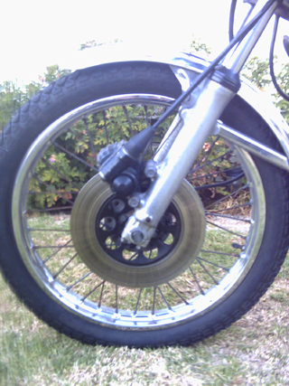

in rgs to the front brakes.. reason it takes so dam effing long to stop is that the front brake is a cable not hydrolic.. just pull said lever and a spring does the work.. sigh.. i was thinking of having the front brake replaced with a hydrolic setup.. it would be the wisest thing to do..

Thats a SMALL front disc!!! if you wanted to mount another brake caliper on the same disc you could technically make up a mount converter if you couldnt find a caliper that would fit on this one.
But looking at the size of it, if i couldnt find the right sized caliper 'd either
a) find out the diameter in MM of the front forks tubes (where they are in the triple clamp), and try and get hold of a set of forks and front wheel that are off a disc braked bike.
b) try and find a disc that'll mount on that wheel and make a mount converter to take a new brake caliper.
of the two option a) would be easier, more sound engineering wise. But more expensive, unless you bought an old shitter just for the front forks and trashed the rest of the bike (or made the remains into a go-kart :twisted:)
R.e. master cylinder, well whatever fits, one off a cb250 would do plenty well if it was a single piston brake caliper.

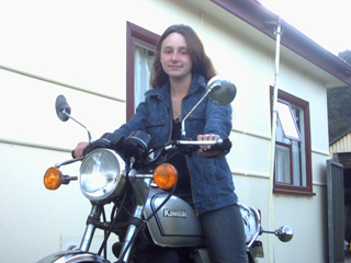

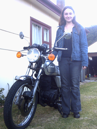

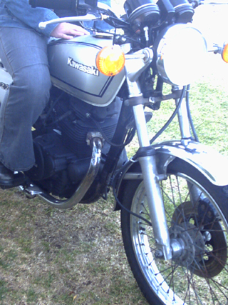

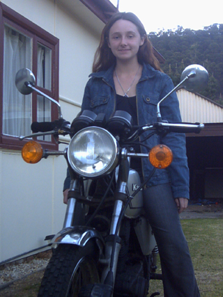

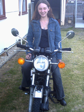

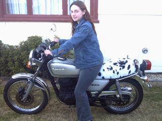

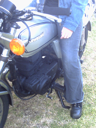

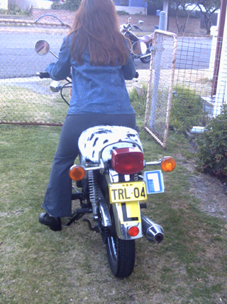

here are a few pix of herself and her machine..:-]
just checked out the review.. that bloke was flogging the z200 at 85 MPH the speedo that i have says its top speed is only 120 KMS.. no wonder the machine was crapping itself..
i have had vix bike running around 80-90 kms for an extended length and it didnt have any of the drama that the bloke who wrote that review was having.. then again i think he bought a real piece of rust on two wheels..:-]
the wreckers in the uk that the other link refers to is a bit expensive.. sheesh.. i did a tally of all the he had available and it comes to a grand total of over 1000 pounds.. about 2.6 k oz.. i am glad i dont live in the uk.. that place seems a real expensive place to stay..
heaps thankx for the links tho.. i got more info out of both of them.. thankx mate..:-]
