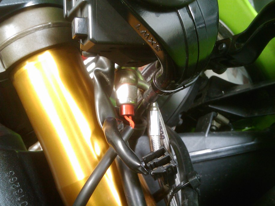

Here is a pic showing the banjo with the switch. I got it as the same time as the MC. The two wires terminate in spade connectors that plugged straight into the factory harness. The 19x20 with zx14 callipers is awsome. The first time I went for a ride I did a little 120 kph stoppie. It's that much better than the standard setup.

nice . ive got the nissin calipers . getting brake lines and looking out for a Master cylinder for a good price.
